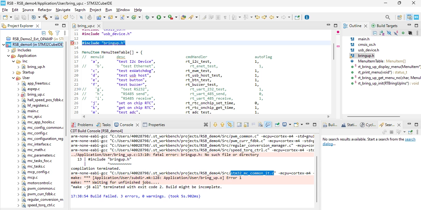

Hi Team,

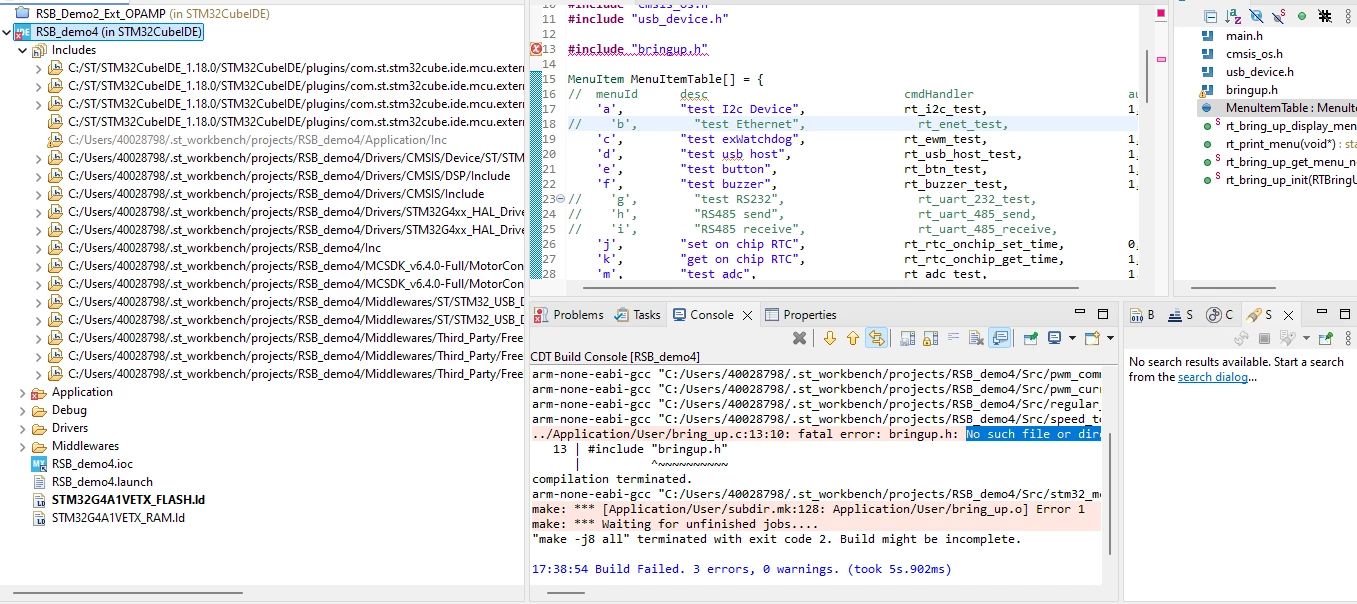

I have created folder for header file and it's path also included in the compiler path but it's grayed out.
but I'm getting this error.
Could you help me on this one.
1 reply

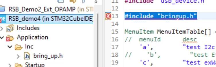

August 21, 2025
The file name is not the same. Missing underscore.
