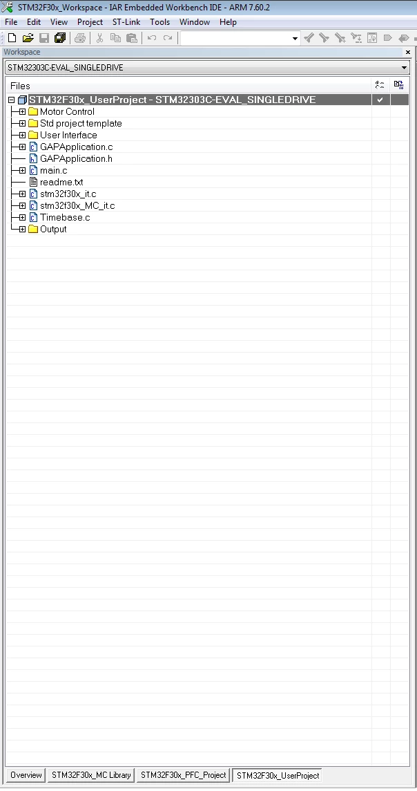

I am experiencing some issues running the FOC SDK v4.3.
My HW-setup:
Control board: NUCLEO - STM303 (ST part number)
Power board: X-NUCLEO-IHM08M1 (ST part number)
PMSM motor
IDE: IAR
Currently I am able to compile and download code to the F303RE, however the motor only spins a short period of time, and then stops, requiring a reset with the black reset button in order to make it start running again using the user button (blue) on the F303RE. I am not sure what the problem is, but I notice that there is no build configuration for the F303RE.
Currently I open STM32 PMSM FOC LIB\Web\Project\EWARM\STM32F30x_Workspace.eww and build using STM32303C-EVAL_SINGLEDRIVE as option in the drop-down menu, please see attached pic.
Why is there no build config for F303RE in IAR drop-down menu?
Should I even be able to compile and download to target when the build config is wrong?
My problems could have all types of sources obviously, but I would like to ensure that I am using the correct build config at least.
#f303re #iar-ide

As I understood Fredrik’s problem, he is using the nucleo board, but needs to select the eval-version of IAR configuration because this is the IAR config that seems to be 'closest' to the 303RE. (At least this was my thaughts when using the same HW configuration (NUCLEO - STM303RE + X-NUCLEO-IHM08M1)).
So with that in mind - is it still meaningful advise porting to nucleo? Isn't it exactly this port Fredrik is asking about?

Yes, you have understood my problem exactly. Indeed the STM32303C-EVAL is based on STM32F303VCT6 and so it is close enough to be flashed to the NUCLEO - F303RE target using project in IAR ported to STM32303C-EVAL.
I was hoping that there was a ready-to-run port for the NUCLEO - F303RE, but as Clive One points out this does not seem to be the case. So it seems I will have to port the code for STM3232303C-EVAL over to NUCLEO - F303RE board.
