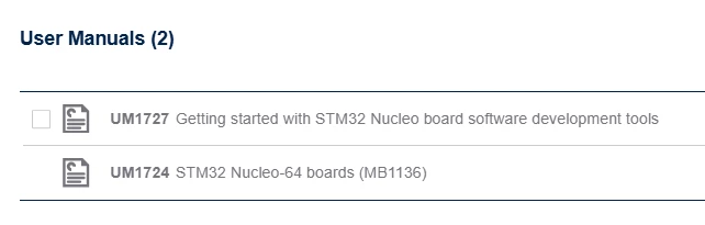

@Zied b. @STTwo-32 This step does seem to be entirely missing from any documentation on the STEVAL-SPIN3204 product Page:
https://www.st.com/en/evaluation-tools/steval-spin3204.html#documentation
On the Nucleo board product pages, there is always a "Getting started with SW development tools":
Perhaps you need the same here?
