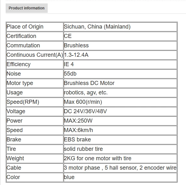

What is "physical abstraction"? Here is some info about the motor.
I set the generator (supply) at 36V, the current at 3A and the RPM max at 200.

Yes I did and this is what I am doing right now but the motor doesn't spin on its own unless I help it first. It want to rotate but it can't. Which is a bit surprising because the motor profiler have no issue making it spin.
September 13, 2023
Try setting the speed a little higher. on your document it is indicated 600RPM so the motor can go beyond 200RPM
