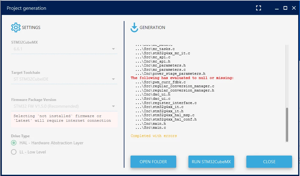

I just start desiging a AC induction motor driver with motor control workbench 5.Y.4.
But I have some problem about it. I can not generate code. I had try many ways but always same result. Its finished with "Comleted with errors" message. I am using https://wiki.st.com/stm32mcu/wiki/STM32MotorControl:SDK_AC_induction_motor link. I am sharing screenshot and log file.  Thanks for your all helps

Welcome @Mnemonic, to the community!
the motor control workbench 5.Y.4 is now obsolete and no longer supported (see available versions on the website X-CUBE-MCSDK), so please upgrade to the latest version.
Regards

Hi Peter;
I know that but I am desiging AC induction motor driver. new version is not support custom AC induction motor solutions. So I need to use this edition

Hello @Mnemonic,
Please note that the version 5 does not allow any hardware customization of the ACIM example. The only customization offered is the replacement of the motor, and this is true for both version 5 and 6, but at least in version 6 all the settings that you must not change are frozen, which is not the case of version 5.
Regards
Cedric

Hi again,
But I can not create default example on it. Also its look like posible to change every setting on dashboard

The two examples provided by the MCSDK are those one :
Regarding version 5, It looks like possible to change every settings, but it is not. Workbench 6 is much more reliable, and allow you to change only what can be changed.
Cedric

Hi @cedric H ;
In versiyon 5 I can change MCU, current resistor, Vbus resistor, ınrush delay control and many things. But in V6 I can not change anything. Dashboard is not support those values. Is it posible to change those type of setting on code? could you share any document about this? if its not I need to use V5
Hi @Mnemonic
For the STM32CubeMX, try to use an upgraded version (for example 6.7.0).
Cordially

Hi @Tarek_ben
I am not sure but I was ask to local ST company this. MCWB 5.Y.4 is support maximum MX 6.6.1edition
