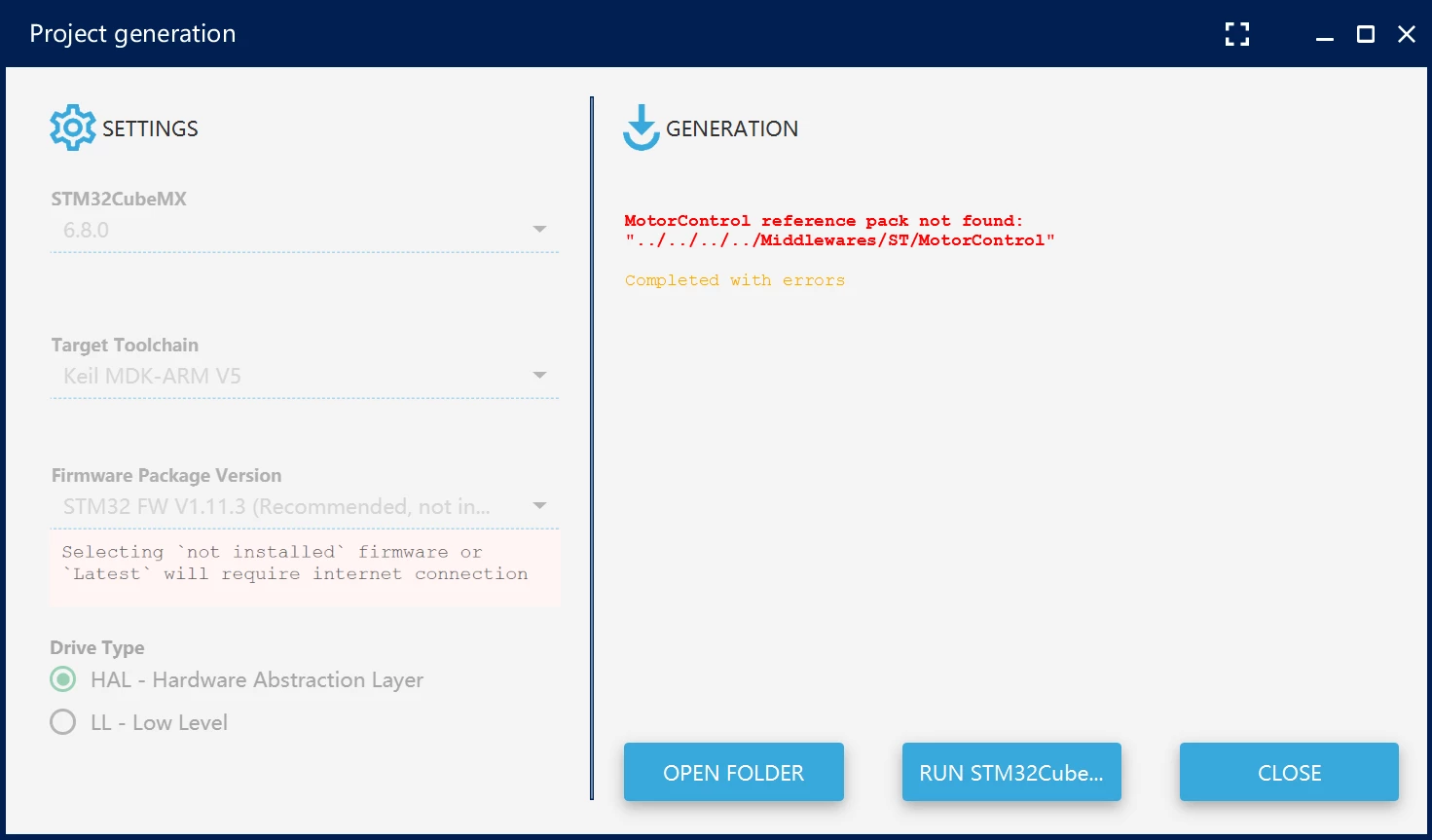

MotorControl reference pack not found: "../../../../Middlewares/ST/MotorControl
MC Workbench cannot generate STM32CubeMX project
STM32CubeMX.Version: 6.8.0-RC4
MC Workbench.Version:5.4.80693W00000aJqRkQAK.png

Mar 28, 2023 12:26 PM UTC
According to the release note of the MCSDK version 5.4.8 it seems that we can use at most the STM32CubeMX v6.4.0 version, can you try with this version and tell me if it works?
Thanks

Mar 29, 2023 5:11 AM UTC
Thank you so much! It works.

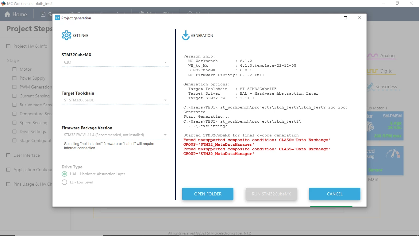

Jun 6, 2023 4:15 AM UTC

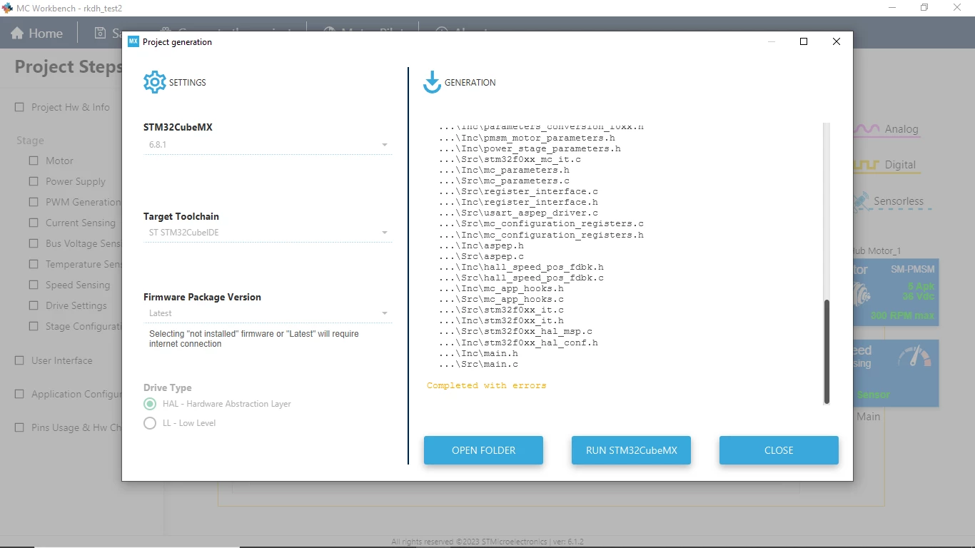

Hi @Zied b.​ ,
I too have a similar problem but with mCSDK version 6.1.2 and tried using STcube MX 6.4.0, all the include and source files are generated but showing an error "completed with errors".
can you suggest what need to be done?
thank you
Vijay
VGani.1

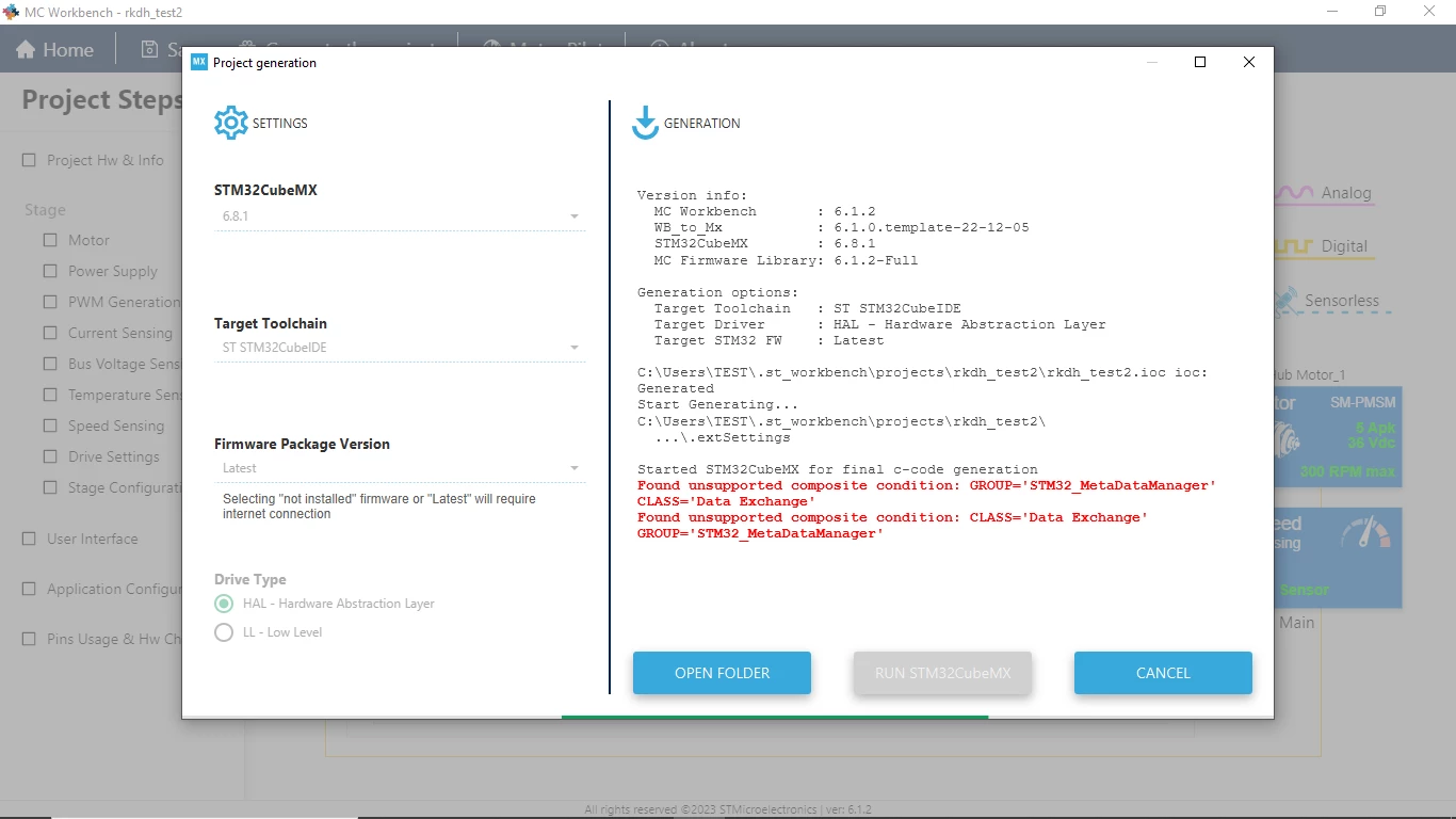

Jun 6, 2023 4:23 AM UTC
Jun 6, 2023 9:00 AM UTC
Hello, according to your screenshot it seems that you are not using the correct version of the MCSDK, it is not version 6.1.2, can you try again with the correct version?

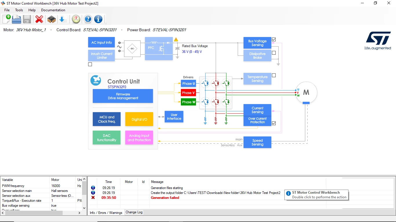

VGani.1
Jun 6, 2023 9:27 AM UTC
Hi Zied b.
Tried with MCSDK 6.1.2 and 5.4.8 but every version is having same issues. Not able to generate the project successfuly.
Please do check and help us in resolving the issue.
thank you

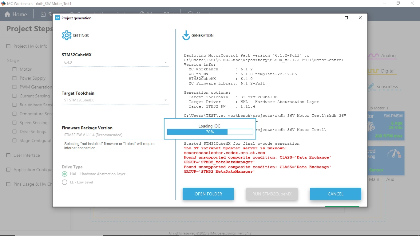

VGani.1
Jun 6, 2023 9:40 AM UTC
Yes tried the latest version and then saw the suggestion here and tried version 6.4.0 cubemx.
I will try again with all the latest versions and send you the screenshot whether its working or not?
Thank you

VGani.1
Jun 6, 2023 10:03 AM UTC
hi Zied,
Tried using latest version of Workbench, CubeMx and IDE. But still the same issue. Couldn't understand the error existence. Please help us to resolve the issue. Do we miss any drivers or softwares??
Thanks
Vijay

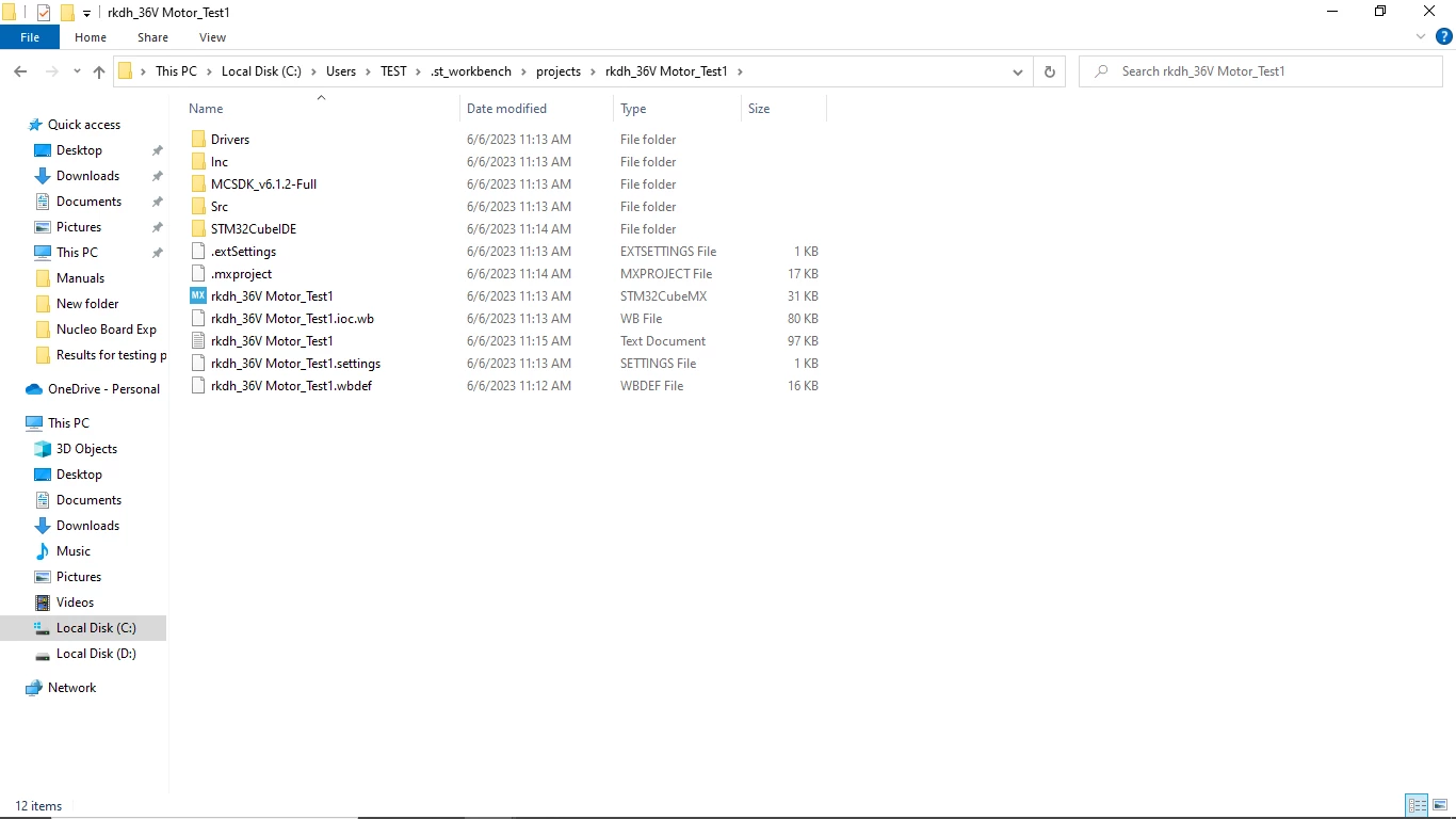

Jun 6, 2023 12:18 PM UTC
This doesn't seem to prevent a compatible project from being created, can you wait then check if the project is building in the location you chose.
can you please give me as much information as possible? in which directory is your Cube mx and your MCSDK installed?
"If you agree with my answer, please accept it by clicking on ""Accept as solution""."

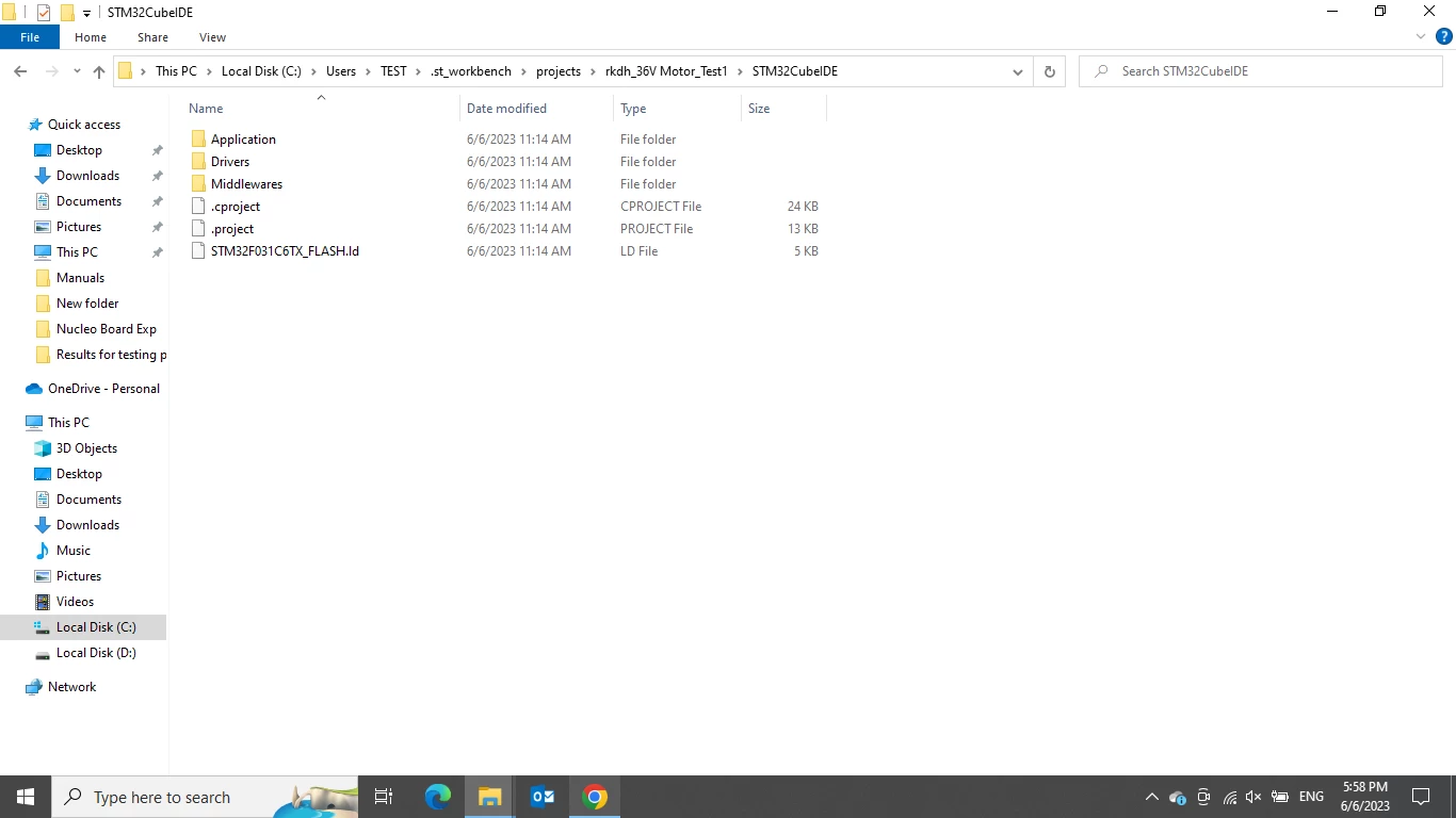

VGani.1
Jun 6, 2023 12:28 PM UTC
If we wait for longer time, all source files and include files are generating but if we press close button, it shows generation is failed.
CubeMx Installation Path: C:/Program Files/STMicroelectronics/STM32CUbe/STM32CubeMX
MCSDK Installation Path: C:/Program Files(x86)/STMicroelectronics/MC_SDk_6.1.2
Jun 6, 2023 12:35 PM UTC
thank you for answer, the generated project should be the one you need, despite the error. We'll be working on a solution to this error.

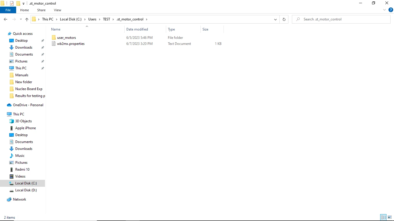

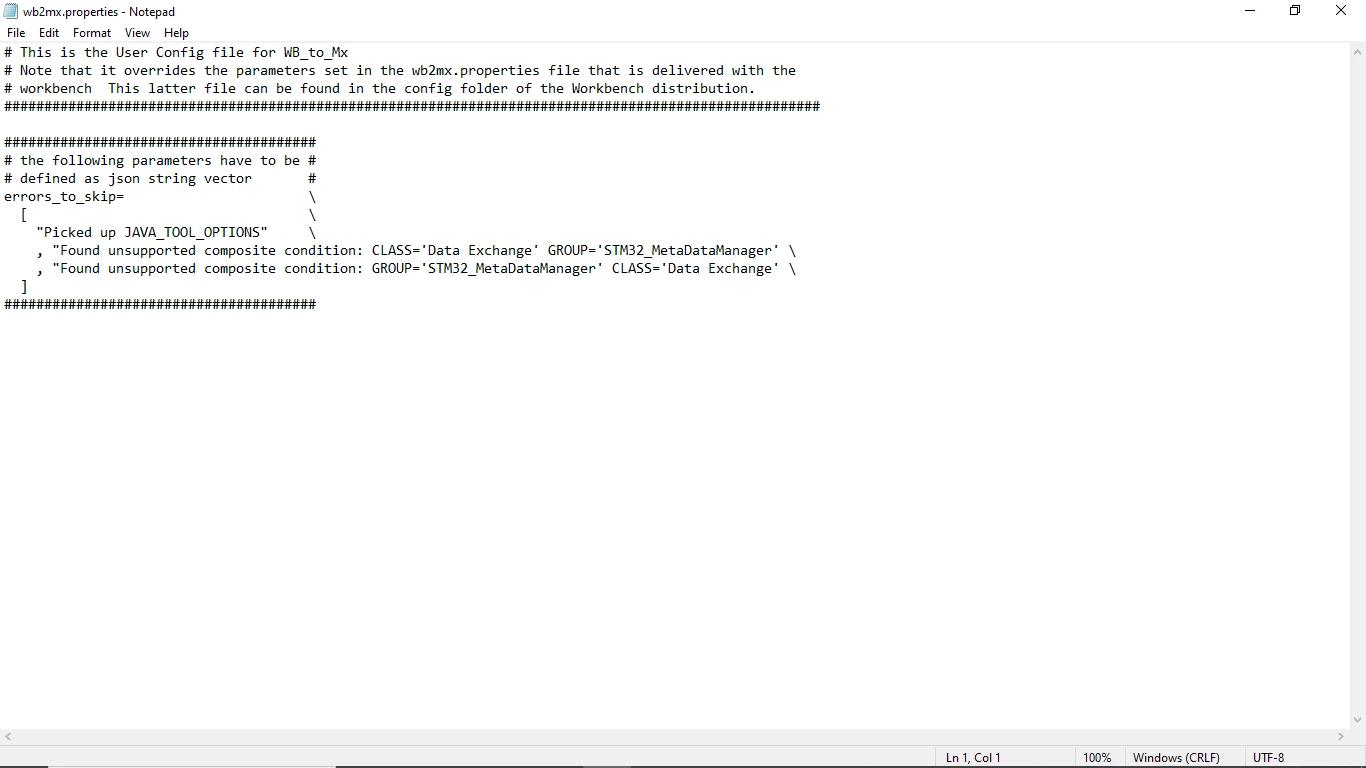

Jun 7, 2023 3:51 AM UTC
Hi, there is no file in .st_motor_control . So we need to create a new file with wb2mx.properties (.txtfile)?? and add these line to it
Jun 7, 2023 7:44 AM UTC
Hello @Community member​ , yes you need to create file named wb2mx.properties and add the above code in it.
VGani.1
Jun 7, 2023 10:09 AM UTC
Hi @Zied b.​ ,
Created a file in .txt format in the folder as you said. But still the error do exist.
