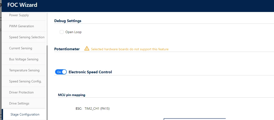

HI I have a motor which I've used for while with many 6-step controllers, including commercial ESCs.
I profiled this motor and it works well with the ST sensorless FOC, but using the same motor profile in a 6-step app gives very bad results, the motor works OK at low RPM, but above 1K or so it makes a terrible squeeling sound and operates very inefficiently.. I had a quick look at the scope but nothing jumped out at me
A couple other Qs:
-Where in the MCW config do I configure the PWM input control?
-Is there an example of controlling the speed with the Potentiometer on the B-G431B-ESC1
Motor control workbench Version: 6.2.0
STM32CubeMX Version: 6.10.0
STM32CubeIDE Version: 1.14.0
Controler/Driver: B-G431B-ESC1 kit
MCW application: Electronic speed control on B-G431B-ESC1 kit (6Step)
    It is available in the Stage Configuration.
    The source code is available in
    \CLN_MCLib\MotorControl\Any\Src
    potentiometer.c
    speed_potentiometer.c
    You have to add to your project and map to one of the ADC's.
