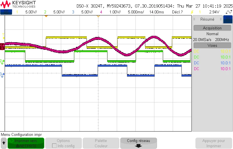

I am trying to run a BLDC motor using the MC control SDK. The BLDC motor is the following: BLDC 40P30F
16P2.063D by MinebeaMitsumi. First, I entered its parameters in MC Workbench + made the profiling for its mechanical parameters, however this step didn't went as expected since I cannot run the motor in full speed, the MC Pilot gives me speed feedback error.
Anyway, I was able also to get the electrical angle offset using the oscilloscope (you can find the picture attached) (which is 120 degree). In addition, I tried to run the motor in Voltage and Current open loop as per the manual. I was able to run it without major problem.
However, when I want to run it in closed loop using the hall sensors, the motor won't turn smoothly. It starts to do a back and forth movement. I tried to tune the PI of the speed control however nothing is changing. + I monitored the hall effect sensor through oscilloscope when I command the motor to run, there are is no noise affecting the hall effect. What could be the issue then?

March 27, 2025
Electrical angle offset how it is 120Degrees. From the rising edge of the Yello Hall signal to the peak of back emf it is around 180 + 60 (i assume) it shall be around 240. Please check.
AnthonyKAuthor
March 27, 2025
Thank you for your reply. I followed this topic: Solved: Is this a 120 or 60 deg displacement angle hall mo... - STMicroelectronics Community that's why I thought it is 120 degrees. In the manual it is written as you have said in your post. I tried with 240 degree it is better but the speed is always constant at 1000RPM however the setpoint is 5000 RPM + the motor sometimes runs and sometimes it blocks or sometimes it runs clock wise and sometimes counter clockwise for the same setpoint
March 27, 2025
I am sorry it is my mistake i got confused
I was referring to the placement electrical angle, the sensors displacement is 120 which is correct which you have entered.

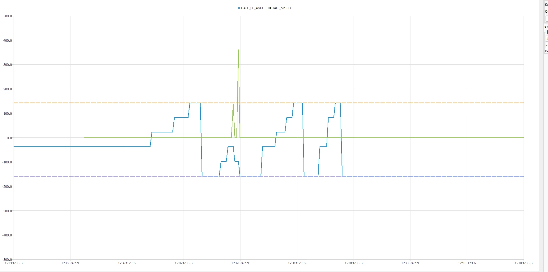

March 28, 2025
Well, the current control loop is ok (I tuned using Open Loop Current). But when I get to the speed, this where the things are strange. I have attached the evolution of the elecrical angle when I turn the motor by hand (few degrees) and that's what I obtain. It is kind of weird no? The angle is always between 150 and -150 degrees? is it normal?

AnthonyKAuthor
March 28, 2025
Well I tried several times with that and everytime I get Speed feedback error; I tried to tune the C2 gain as recommended and it is not working. In addition, in the rev-up table, I cannot set anything the values keep on going back to zero I dont know why. It is really frustating. I was able to run without profiler using sensorless mode, but when I am doing a profiling, when I get to 28% the motor stalls and makes weird noise

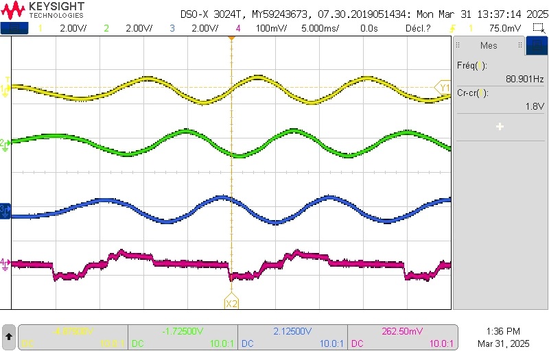

March 31, 2025
Good Morning,
Just for updates, I was able to run the profiler for the hall sensors and it worked. The FOC now with Hall effect sensors is running but the weird thing is that I needed to switch hall sensors H1 and H2 (I knew because of the profiling, it gave an information to swap H1 and H2) and by doing so I got 0 degree as offset. however, I looked into the  oscilloscope, the signals are not coherent with the theory. I don't know why it works by swapping both signals. +  When I looked on the induced emf when I turn the motor by hand in CCW (as mentioned in the pdf), I have the right phases between phase A, B,C (which is a positive sequence). However, it seems when I command the motor via Motor Pilot, the rotor turns CW.
