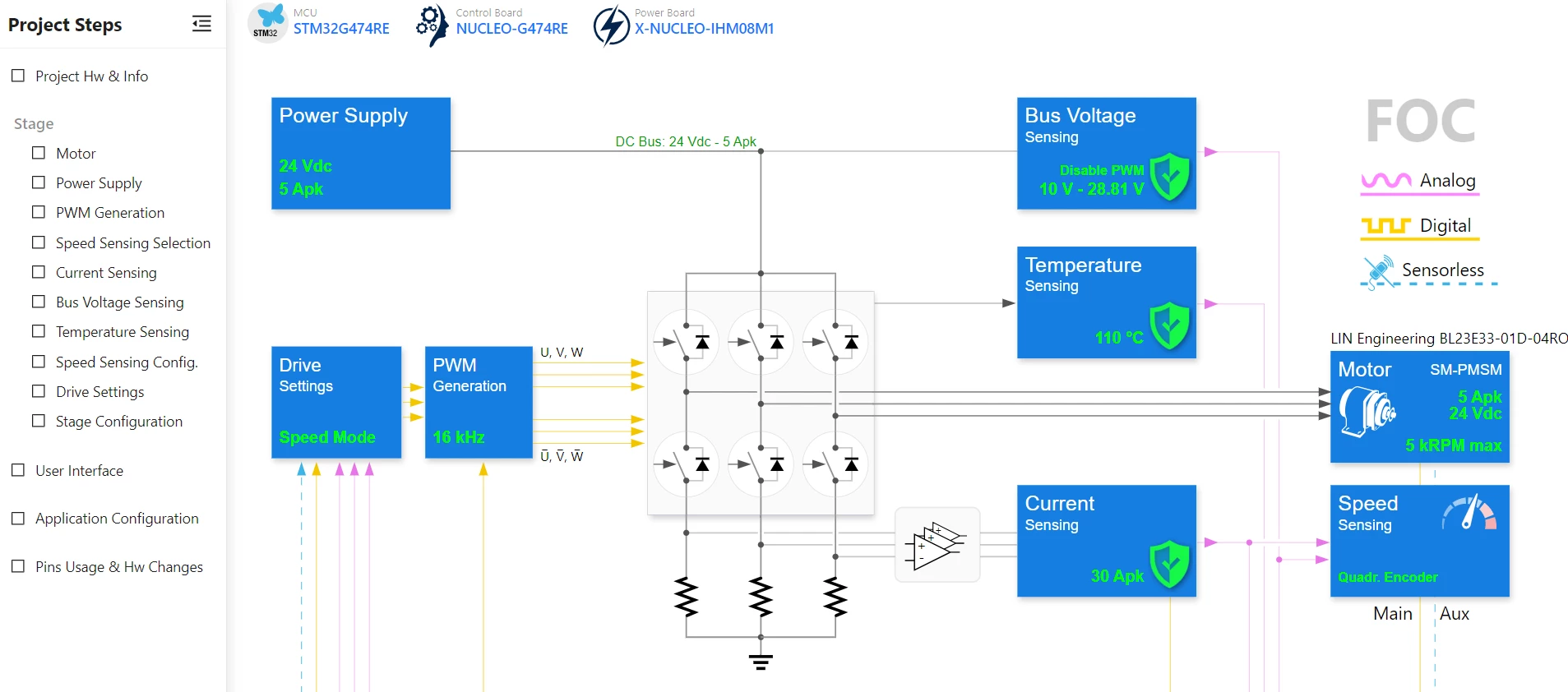

Hi everyone, I’m using the X-NUCLEO-IHM08M1 with the g474re core and a BL23E33-01D-04RO motor (which reaches 4000 rpm).
I want to use FOC and the motor’s internal encoder, so I’ve made the hardware modifications described in the IHM08M1 manual and those also required by MC Workbench before code generation. I have therefore set the main sensor to the encoder and the auxiliary sensor to the sensorless PLL+observer.

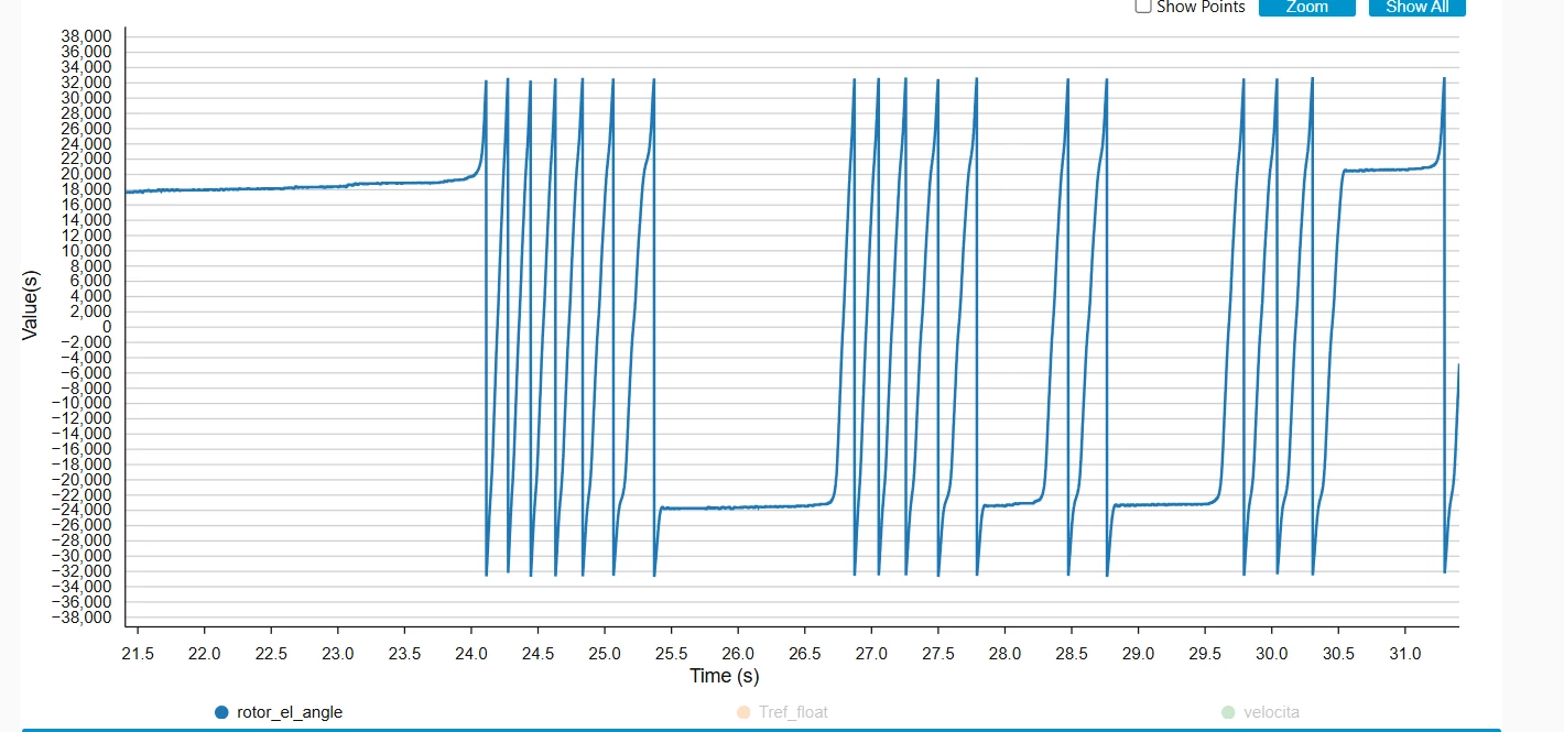

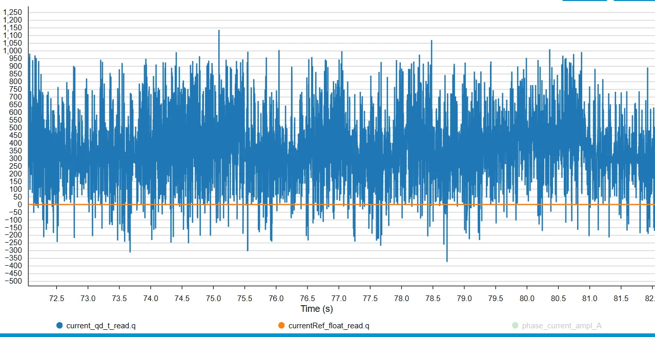

In STM32CubeIDE, the motor runs smoothly and the speed is correct, but at low speeds (below 60 rpm) it freezes and sometimes lags... I have no reported firmware errors. I don't have any load connected to the motor (yet).
What could be causing this? PID?
I can provide screenshots of the signals you want; I’m using CubeMonitor.

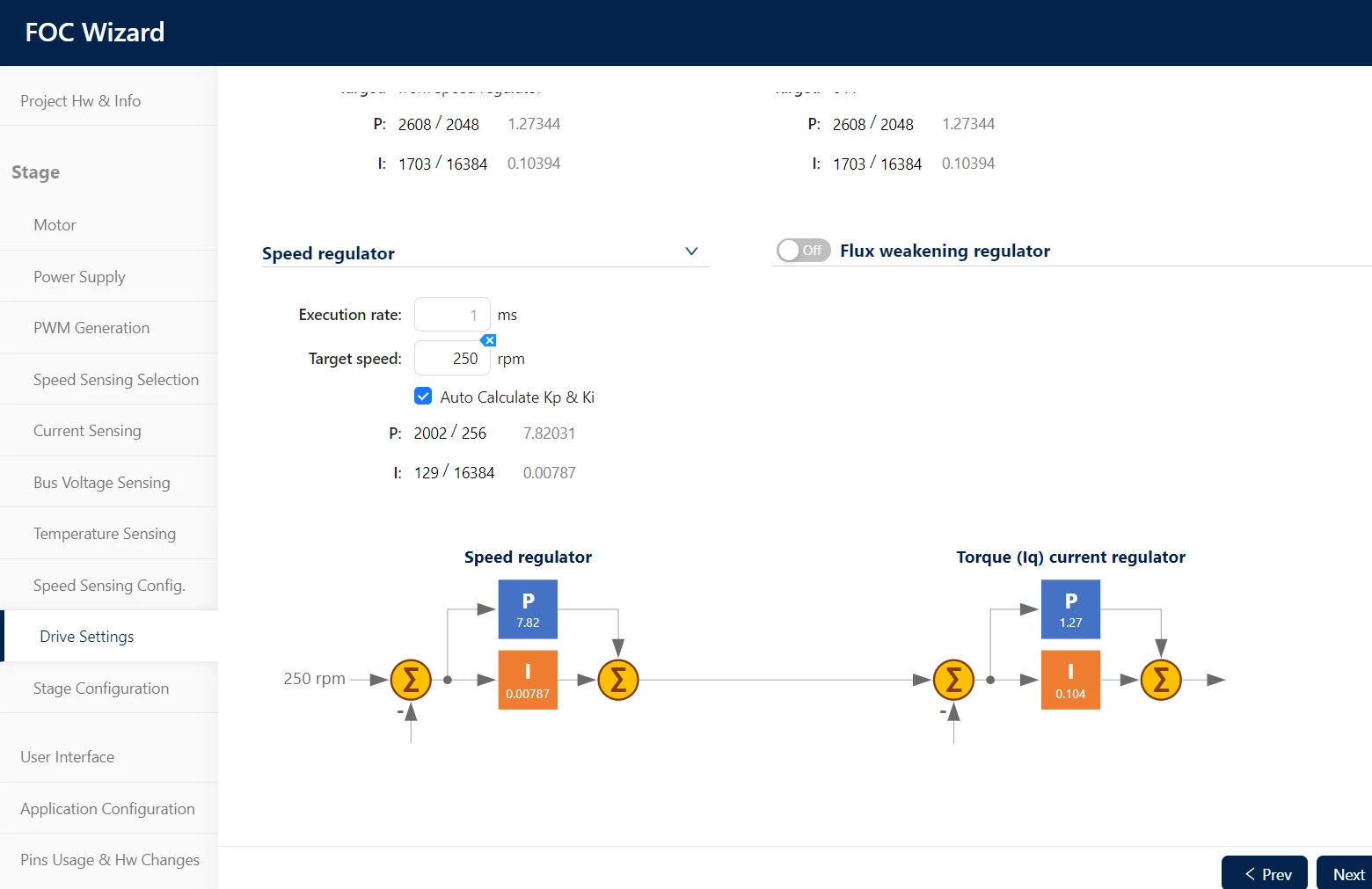

PID: autocalculate Kp & Ki for both current and speed regulator

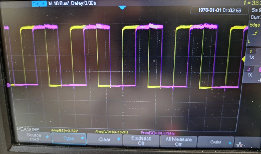

Encoder from oscilloscope:
https://streamable.com/2xdrsx
(If the link expires, let me know and I'll update it)

This behaviour is normal in FOC drives at very low speed. Below a certain rpm, the available feedback and the motor’s back-EMF become very small, so friction, cogging torque, measurement resolution and controller tuning have a much stronger impact.
So it is not necessarily a firmware fault or only a PID issue. The low-speed instability comes mostly from a combination of speed-loop tuning, encoder speed quantisation, and the limitations of sensorless estimation at low speed.

The SPEED proportional-integral (PI) regulator parameters can be adjusted with the MC Motor Pilot tool: Advanced Configuration, use Speed PI regulator parameters.
