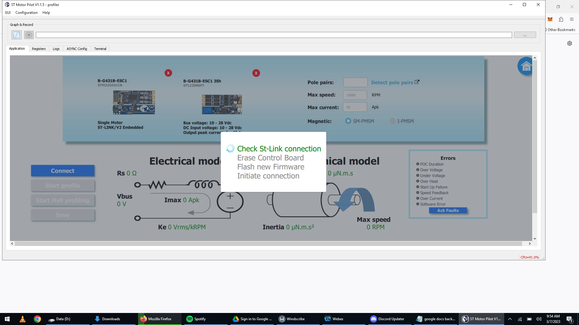

March 7, 2023
The version 6.1.1 of the motor control workbench and the motor profiler included in it hangs at the stage where the profiler is trying to connect to the board. The board and everything else works, I am able to program the board using Arduino.
This is where it hangs.
So, to be clear, there are two different errors. This is the one that occurs with version 6.1.1 of the sdk. I had that problem before and tried to uninstall it and install 6.1.0. That was able to flash the firmware once, but then it gave the error thereafter that is discussed above, where it said the MCU was not supported.0693W00000aIOMuQAO.png

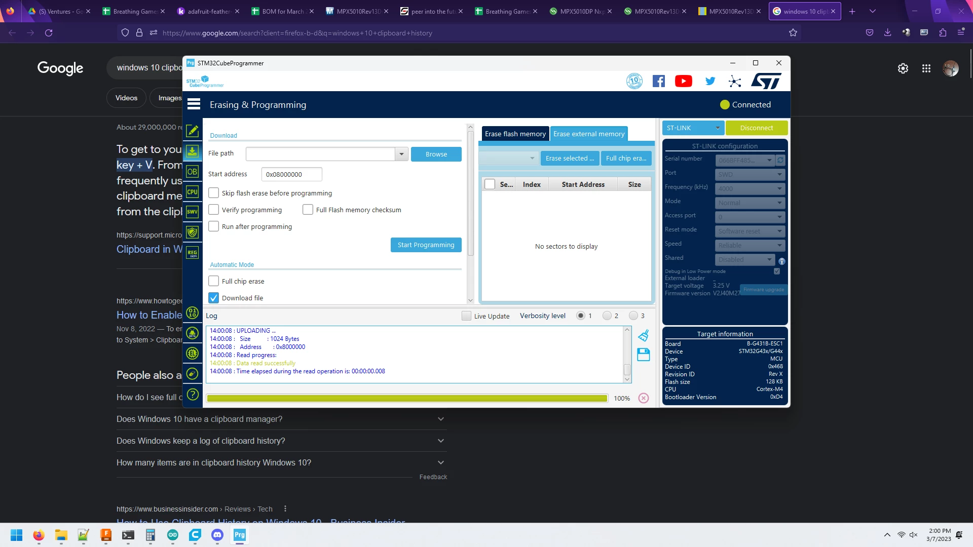

Can you connect your board with StM32 Cube Programmer and send me a screenshot of your interface?
After that can you try to erase the memory of the MCU on Cube programmer (Erase button on the bottom left of Cube programmer Gui ) and try profiling again ?

March 7, 2023
Here is the screenshot of the connection working fine in stm32 cube programmer:0693W00000aIOMuQAO.png

Can you send me the right screenshot of cube programmer?

March 7, 2023

Hello ,
Everything seems to be correct with your board,
can you get the file "B-G431B-ESC1#B-G431B-ESC1 3Sh#(6.1.1).hex" which is in the directory : \MC_SDK_6.1.1\Utilities\PC_SoftwareSTMotorPilotSTM32CubeProgrammer\Fw and flash it manually with Stm32CubeProgrammer then try to connect manually with the profiler.
If you have the possibility to make a video screen capture so that I can understand where the problem comes from?
