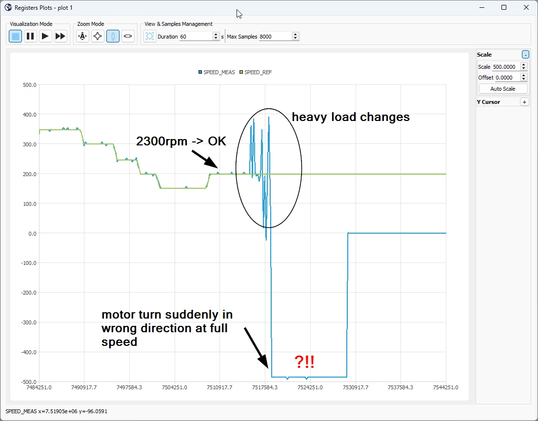

Motor suddenly turns in the wrong direction
[PN]: Customer Board (Very similiar IHM08M1 and STM32G431RB)
[VERSION]: 6.3.1
[TOOL]: Motor Pilot
[DETAILS]: at heavy load step the motor turns suddenly in wrong direction with full speed (see plot below)
[EXPECTED BEHAVIOR]: stable speed or motor stops with speed feedback error or over current error
[HOW TO REPRODUCE]: Use PMSM Motor with FOC (STO+PLL as primary Sensor, 3shunt),  STM32CubeMX 6.12.1, Target Toolchain ST STM32CubeIDE, Firmware Package Version STM32 FW V1.6.0, Drive Type: LL

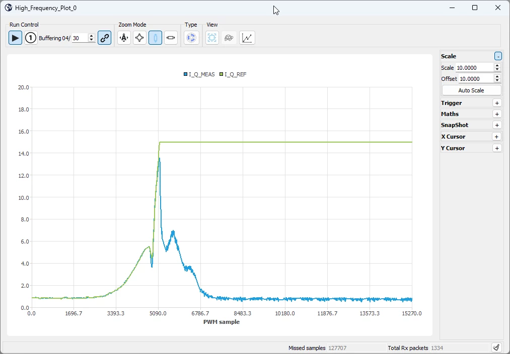

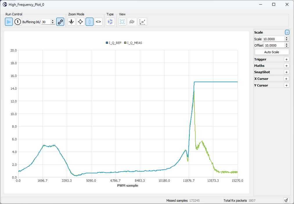

Could you plot the IQ_MEAS and IQ_REF during the error use case?
You can decrease the STO-PLL variance threshold to make the system more sensitive to incorrect speed estimation.

Attached you will find two plots showing IQ_MEAS and IQ_REF at the moment when the motor starts turning in the wrong direction.
I also tried reducing the variance threshold from 25% to 10%, but unfortunately, this did not resolve the issue.
However, I discovered that lowering the PLL Kp in the Observer from 250 to 120 makes the problem less severe or almost eliminates it. That said, this adjustment results in poor control at low speeds.

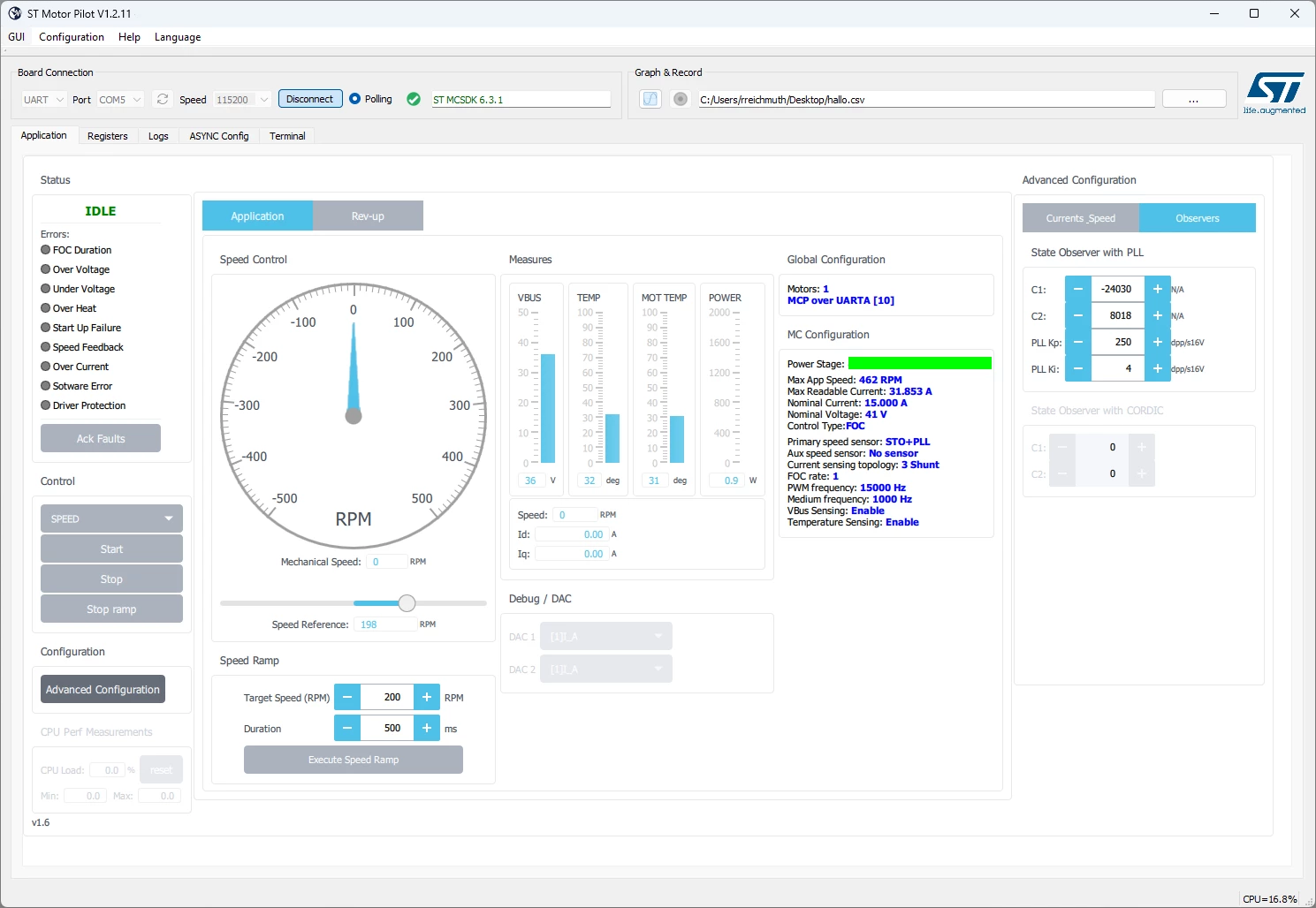

Any tips on how to optimize C1 and C2?
GMA
September 2, 2025
Hello @RReic.2,
If you are referring to G1 and G2 observer gains, review the 2. Back-EMF state observer (STO) chapter in the Speed and position feedback sensorless algorithms section of the user manual. This documentation is available through the Workbench tool by navigating to About > Documentations > Documentation.
Gain1 is related to the current estimator, and Gain2 is related to the back-EMF/speed estimator.
