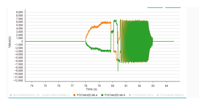

Motor spins under load in one direction and not in reverse direction
I have two issues
Project details:
a. Custom board.
b. MCSDK 6.2.0, FOC, 15HKz , 3 shunt topology , BLDC motor,
c. Motor pilot not configured

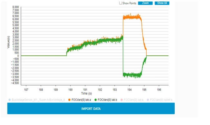

Issue1- I have calculated the Hall placement angle as mentioned in the documentation in one direction (clockwise). The motor smoothly starts also under loaded conditions, there are no issues. But when i try to spin in reverse direction with negative Iq under the same load it does not start.
I plotted Ia, I b using cube monitor
Motor does not start in reverse direction.
Motor runs smoothly without problem in forward direction. How do i debug the issue?

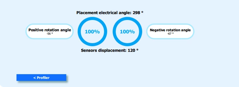

It has something to do with the quality of your motor.
If you need to spin your motor in both directions you can take the 298 Degrees value which is the average of the Positive rotation and negative rotation.
If the control is not accurate enough with this average value, you can always change dynamically the placement depending on the motor direction.
Regards
Cedric

I have gone through the documentation i am trying to setup the motor profiler for my custom board but it may take some time for me to understand and setup. But when i see the documentation
it mentions that the motor will run in both directions and i can see positive rotation angle and negative rotation angle and then the placement electrical angle which is different
Positive rotation angle -56Degrees
Negative rotation angle -67Degrees
Placement electrical angle 298Degrees
But when i do the manual method mentioned in the document it is not that detailed
I have tried different hall placement angles within the range of +- of actual value but the performance is always better in only one direction. It has something to do with hardware or software?
