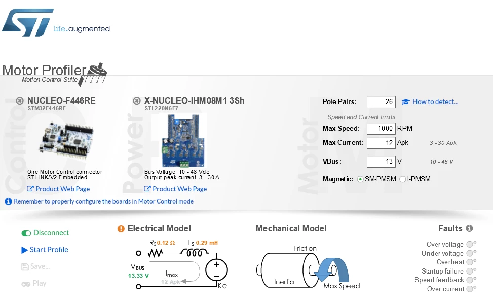

I am currently testing a 48 volt 600 watt motor.
Tried to test using Profile motor, but motor doesn't run smoothly.
I can only use 12 volts.
When I power over 14 volts there is no motor rotation.

When you provide 14V using the profiler which is the error that you get? Can you attach some screenshot?

Thanks for answering me, this is my picture.
From many years I have been working on this one with no success. Thank you.

It can depend by the implemented motor profiler firmware that is not compatible with the specific motor that you are using.
A suggestion in this case is to create the project using the Motor Control Workbench and insert the parameter into it. In particular you can:
Insert the Stator Resistance and Inductance estimated by the profiler or use a RL meter connected between two of the motor phases (and divide by 2)
Compute the Bemf constant (Ke) rotating by hand the motor and use a voltage probe connected between two of the motor phases
Ke is Voltage line to line (so between two phases) RMS value (or peak divided by 1.414) over kRPM
This last one can be computed considering the frequency of the measured BEMF, divided by number of poles pairs (to get the mechanical frequency) and then multiply by 60. Now you have the RPM to get the kRPM just divide by 1000.
You can add this to the Workbench Project.
Filling up the other parameters like poles pairs max application speed etc
The remining steps are to define the sensorless startup ramp and after that the speed regulator parameters....
Unfortunately a lot of steps that the motor profiler does under the hood and you need to do manually.
