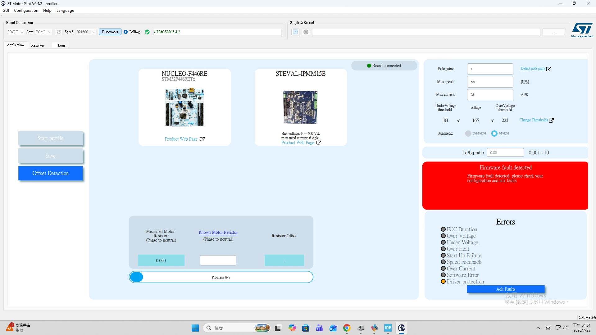

We are using STM32 Motor Profiler to identify the parameters of an IPMSM motor, but the profiling process always stops at approximately 7% and reports a “Driver Protection” fault.
Hardware configuration: - MCU board: NUCLEO-F446RE - Motor-control expansion board: X-NUCLEO-IHM09M2 - Power board: STEVAL-IPMM15B -
Motor type: IPMSM
Thank you.

Jul 23, 2026 6:28 AM UTC
We have read the user manual and conducted the experiment according to its instructions. However, the driver protection fault is still being triggered.
We have checked the following:
  • The wiring and settings of SW1, SW2, SW4, SW5, SW6, SW7, and SW8
  • The known motor resistance measured between the U, V, and W phases
  • The use of two ADCs
The driver protection fault is triggered immediately when we click “Offset Detection.” However, after pressing “Ack Fault,” the driver protection warning disappears immediately.
What could be causing this issue?
In addition, the progress remains stuck at 7% during both “Offset Detection” and “Start Profiler.”

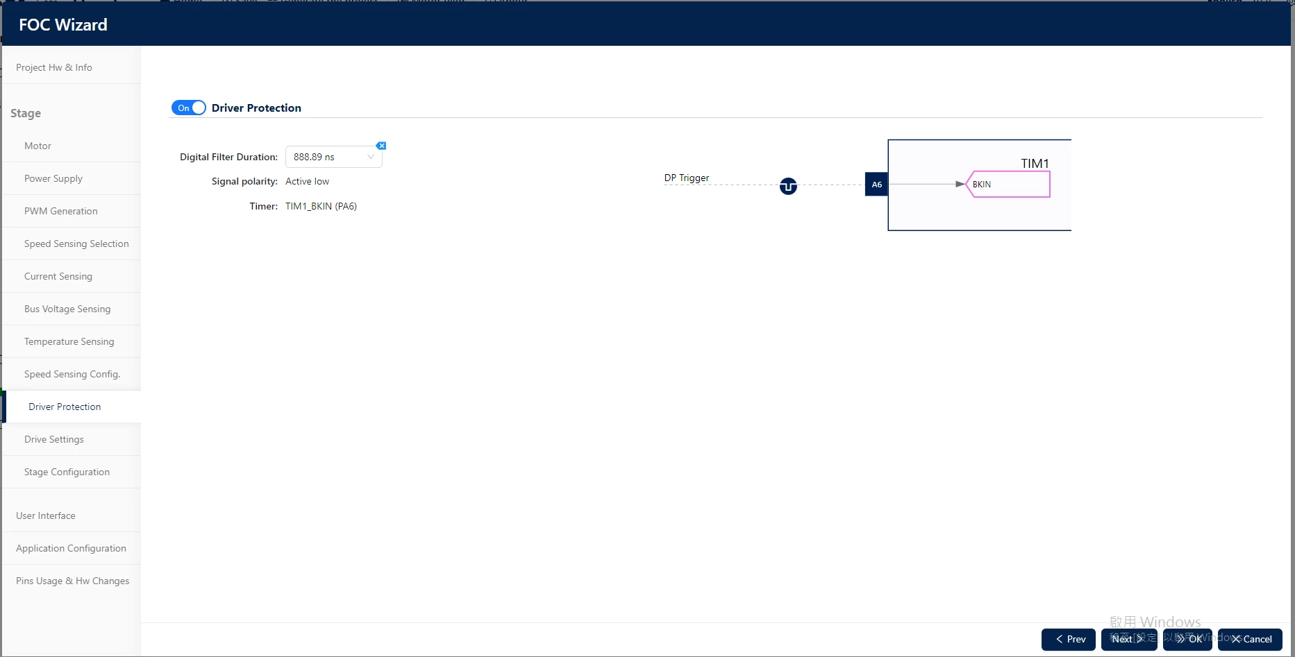

Should I extend digital filter duration.
