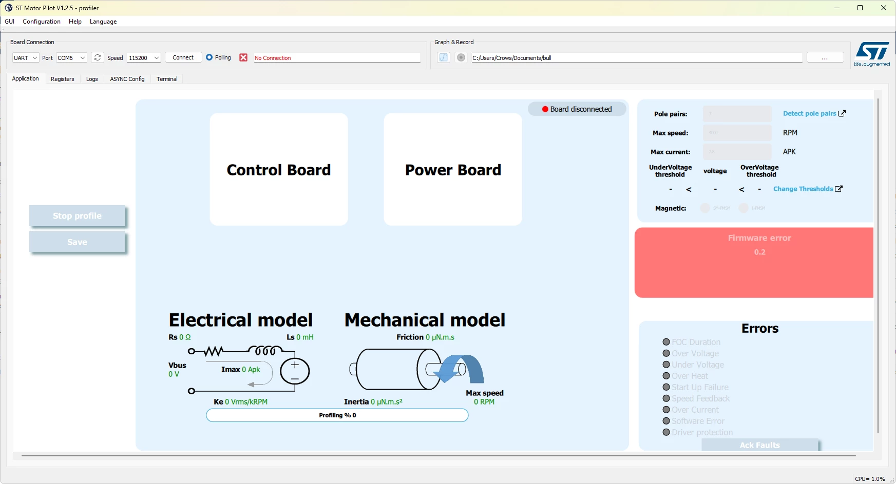

Motor PRofiler gives "Firmware Error 0.2", Flashes boards and stops working
  • November 12, 2024
  • 1 reply
  • 1073 views

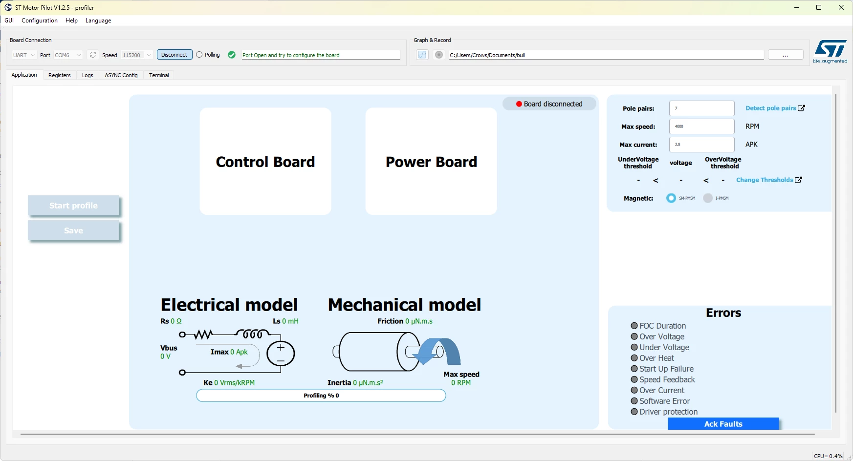

When I try to connect with pollling on, the Control and power board flash briefly before going white
   The error displays for a time
The application is unusable.
If I switch polling off, I can connect to the board but the application still does not work
    I also get a confusing "Port Open and try to configure the board" in the connection dialog and  simultaneous "Baord Discconnected" in the application panel
WHat does the error mean?
Can we not get a decent error message displayed?
Works with bull running motor, but not with others
If polling is switched off, the board connects and sometimes lets me start a profile, but does not get any results.
Most often the buttons are all greyed out and the input fields are inaccessible
Terminal has the following line which may be of use
ASPEP_BEACON Mismatch on crc_cpacility RXS_Max TXS_Max TXA_Max
Unfortunately the  terminal content is in a table and needs to be copied cell by cell

Hello @shorai,
It is a known issue on Motor Control Pilot version:1.2.5.
Could you please try with our latest version available here.
