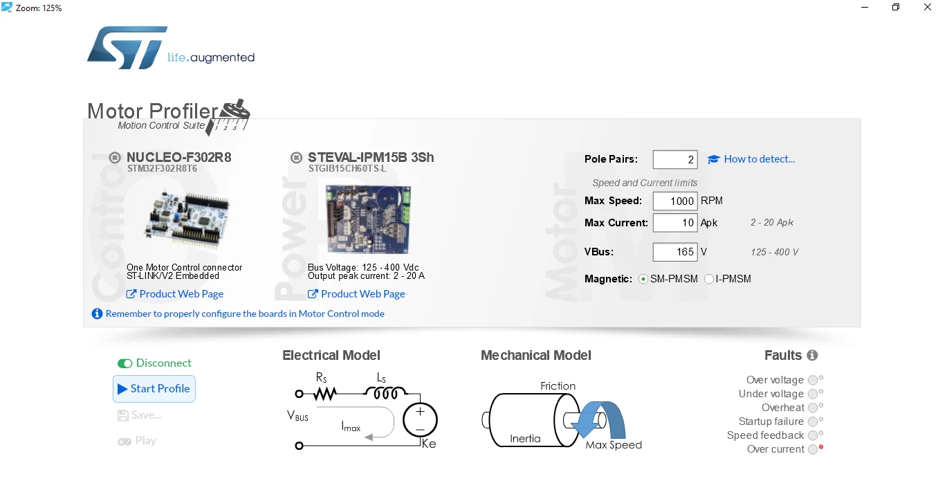

I have IMP20B with Nucleo Board F302R8.
I tried with Motor Profiler. In over current small dot shows red and profile failed.
With same configurations i tried once & motor runs a bit.

Darshan Patel
November 3, 2020
Darshan Patel
November 3, 2020
Hello Just Zoom the corner Faults Section, Its due to External SMPS???

Hi Darshan,
I'm here following the link in this previous post.
I see from the screenshot the board selected in the profiler is IPM15B.
However you mentioned that you have a IPM20B. Do you confirm ?
If so, consider that the two boards are different, so maybe it could be the cause of this issue.
Moreover, even without any error, using a different board bring to an incorrect profiling of the motor values.
Darshan Patel
December 1, 2020
Yes you are right i used IPM20B instead of IPM15B.
I agree with your feedback with using IPM15B. but motor once runs for few seconds.
