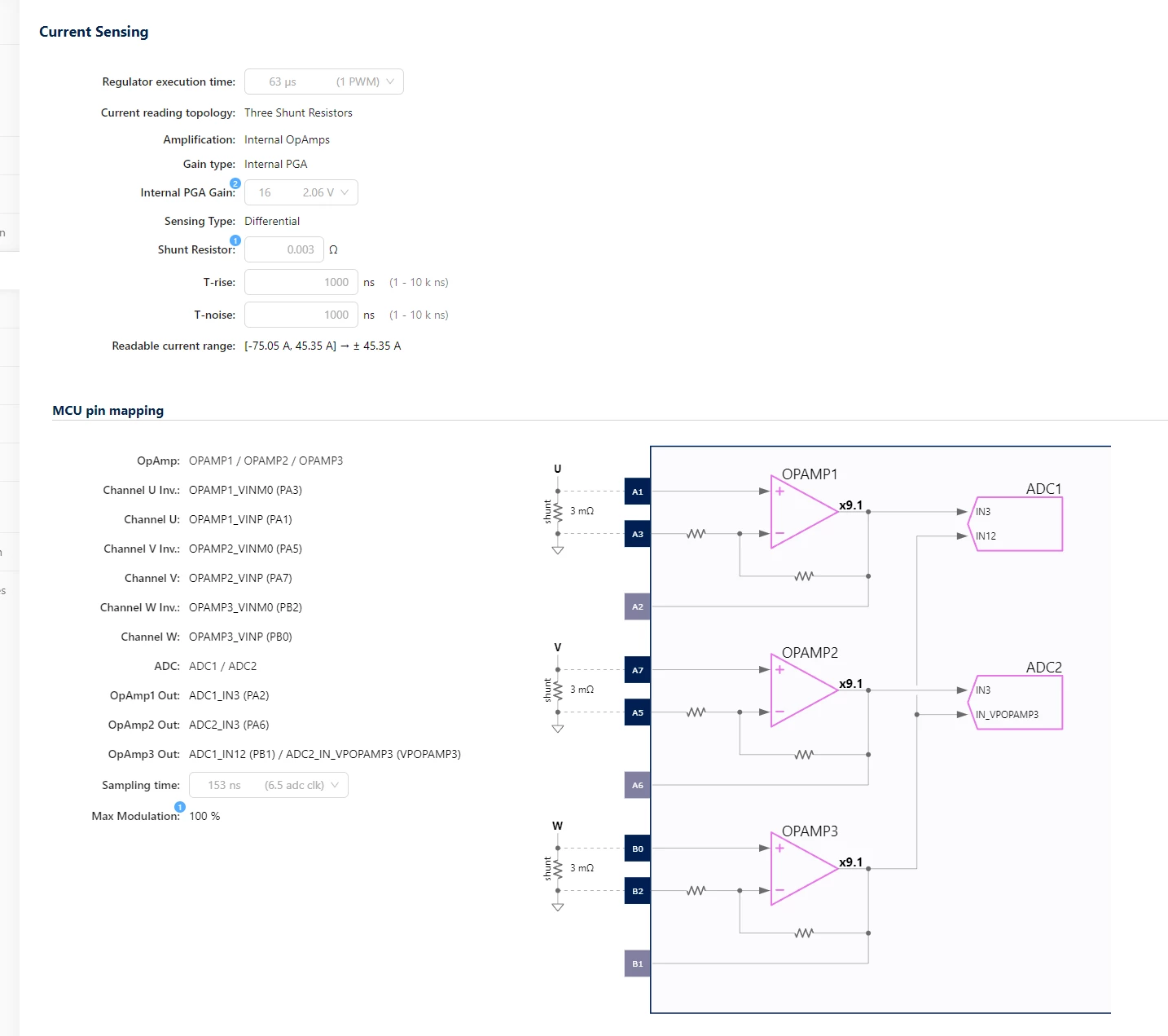

I finally found your documentation. Thanks.
I'm using B-G431B-ESC1 standard board. If needed, it's revision C.
And 2 adcs seems to be configured as requested in the above documentation.
Generated CubeMx file seems to be correct according to the above screenshot.

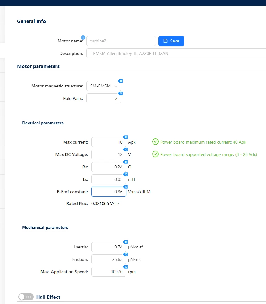

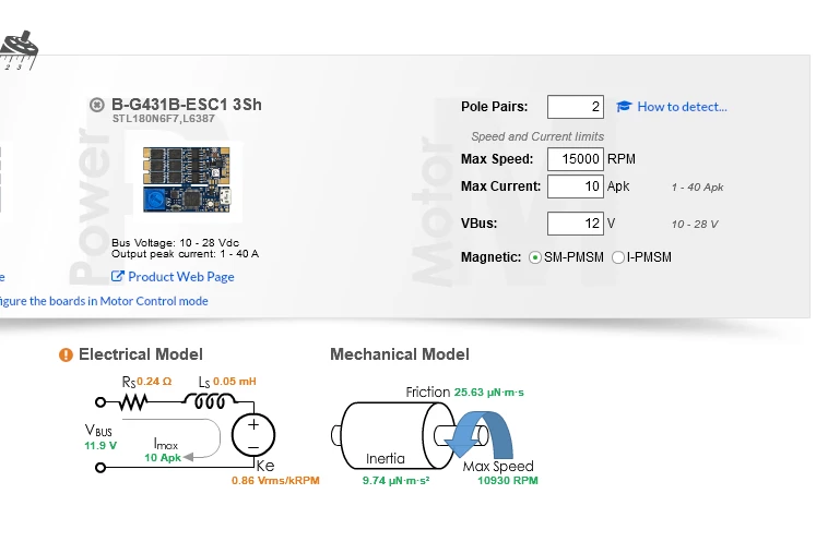

Nov 28, 2024 11:55 AM UTC
Hi
So, I put this settings:
into MCW:
Which leads to this json file :
 "hardwareFamily": "MOTOR",
 "label": "turbine2",
 "description": "Turbine",
 "polePairs": 2,
 "nominalCurrent": 10,
 "nominalDCVoltage": 12,
 "rs": 0.24,
 "ls": 0.05,
 "magneticStructure": {
 "type": "SM-PMSM"
 "BEmfConstant": 0.86,
 "inertia": 9.74,
 "friction": 25.63,
 "maxRatedSpeed": 10970,
 "compatibility": ["FOC", "sixStep"],
 "id": "turbine2"

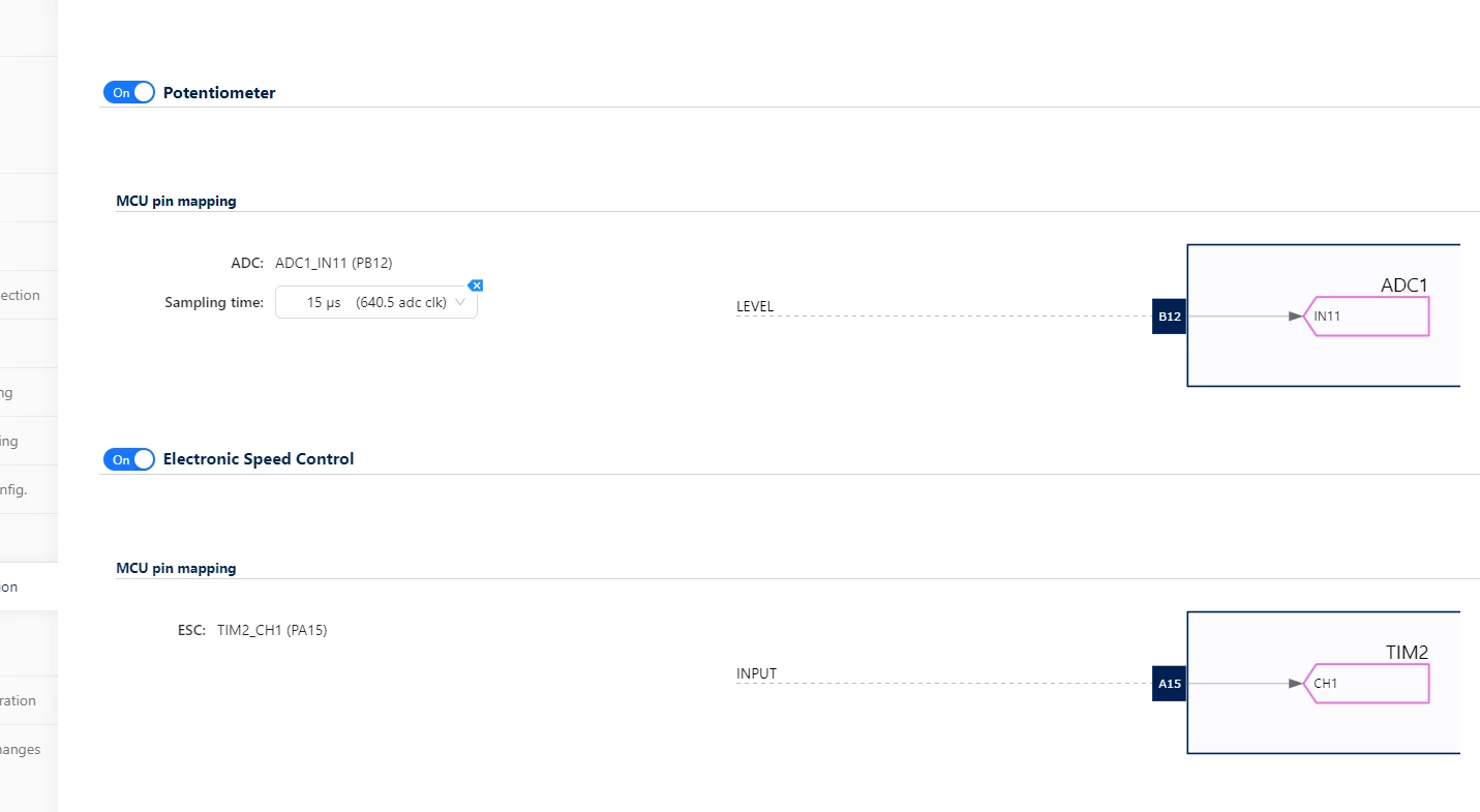

I activated potentiometer and electronic speed control which settings are coherent with schematic:
Now when I click the button on the board to start the motor, the behaviour looks like while profiling:

Nov 28, 2024 1:27 PM UTC
Hello @JulienD,
I am sorry but I missed one point, the "beep-beep" is coming from the fact that Electronic Speed Control ESC is enabled:
Could you please try disabling it?
Electronic Speed Control is described in UM2516: Electronic speed controller Discovery kit for drones with STM32G431CB.
If you agree with the answer, please accept it by clicking on 'Best answer'.Best regards.GMA

Nov 28, 2024 6:05 PM UTC
Test 1:
- I removed esc feature.
- opened motorpilot
- loaded gui SimpleAppMCPV2.qml
- error -> this gui does not support motor profiling app (something like this).
- removed motor profiler from "application configuration" tab
- restart gui.
- motor runs smoothly.
Is it what you requested?
Test 2:
- no motor profiler in app configuration
- esc enabled
-  potentiometer enabled
-> with this configuration, the motor does not start with the button, whatever the position on the potentiometer.
GMA
GMABest answer
Dec 3, 2024 8:47 AM UTC
Hello @JulienD,
Test1: yes.
Test2: if you want to use Potentiometer feature, only select Potentiometer feature and disable ESC.
It is not possible to control speed with both feature (ESC and Potentiometer) at the same time.
