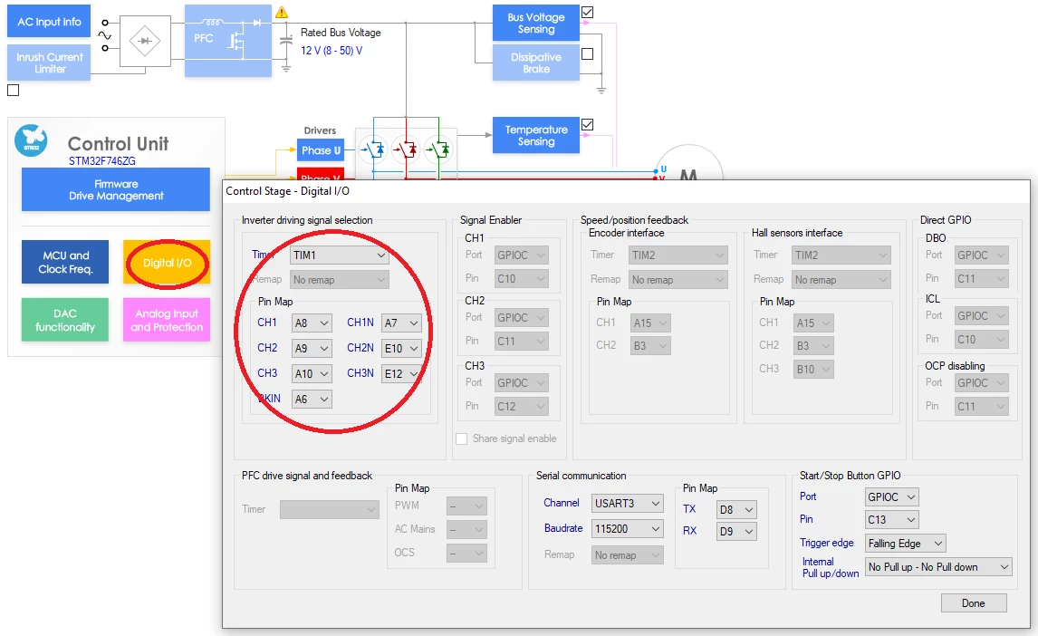

In the Workbench, did you create a new project with these two boards?
Did you use the ST Zio connectors to connect the boards?
In this case I suggest to check the proper mapping of Inverter driving signal (Digital I/O windows, TIM1 Pin Map):
Let me know if these info are useful to you.

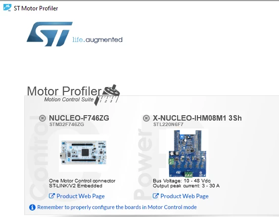

That's a shame that I bought this board as it is listed in the compatible list of the motor profiler (as in the picture below).

you are right, in my previous tests I was using an old version of Motor Profiler (5.4.3) where the board NUCLEO-F746ZG was not yet present.
Did you properly configure the boards in Motor Control mode?
You can find the configuration procedure step-by-step clicking on the "info" message below the boards.
