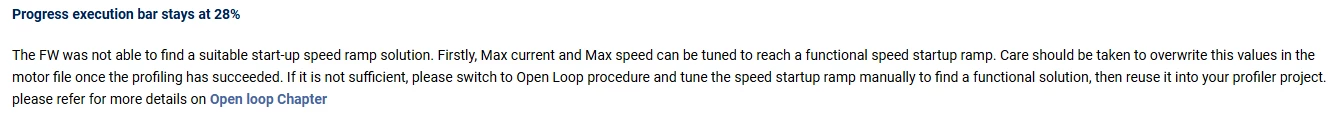

Motor profiler cannot recognize brushless coreless motors
Motor Proiler 识别无刷空心杯电机的时候,卡在28%,套件用的是
Translation:
When the Motor Profiler identifies a brushless coreless motor, it gets stuck at 28%. The kit uses...
STuser2Best answer
Senior III
Dec 29, 2025 1:34 PM UTC
Check the MCSDK documentation in the above section.

I used it on coreless motor, motor profiler is not mandatory. What motor are you using ?
