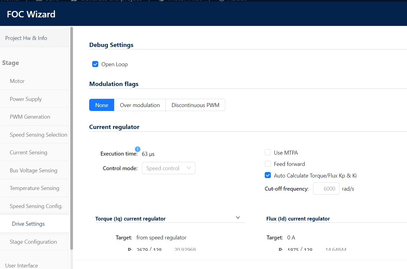

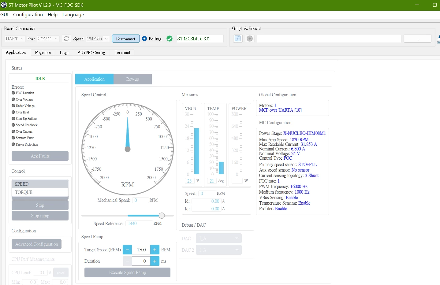

I want to test the open-loop function of FOC. I have already checked the "open loop" option under "Debug Settings" in the "Drive Settings" page of Workbench. However, when I run Motor Pilot, the "Open Loop - Voltage" control option does not appear in the control menu. Is there anything else I need to configure??

Hello @Vincent7,
According to the motor pilot interface, your project has been generated in "profiler" mode. Disable it and generate the project, "Open Loop: Enable" should appear in motor pilot interface.

Hello GMA,
Thank you so mucn, the Open Loop-Voltage option has appeared.
