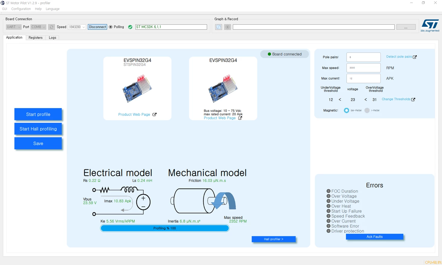

I had the motor profiling experience to get motor mechanical and electrical parameters using EVSPIN32G4 boards
as following:

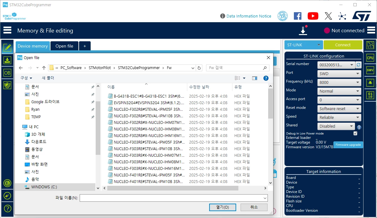

Now I'm trying to start the project for controlling a new high power motor with EVLSERVO1 board.
But, I couldn't find the ST provided firmware for EVLSERVO1 board as listed this.
I'm wondering the EVSPIN32G4 firmware is compatible with EVLSERVO1.
Thank you for your any advice.

Hello @rokkie68,
The EVLSERVO1 board is available with the Motor Control Software Development Kit (MCSDK) version 6.4.1, which can be accessed here.
Refer to the Getting Started with ST Motor Control SDK document, accessible through Workbench tool > About > Documentations > Documentation.
