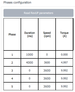

I'm having following issue with the Motor Pilot that comes with the MCSDK 6.2.1 (V1.2.5).
I try to modify the Rev-up phase configuration.
Now when I write a torque value in any of the phases, this value resets to zero and is saved on the board (pressing "Read parameters" returns the zero values). If that happens, I cannot set it to any other value until I power-cycle the board, in which case it resets to the values predefined in firmware.
Any way to make this feature usable again?

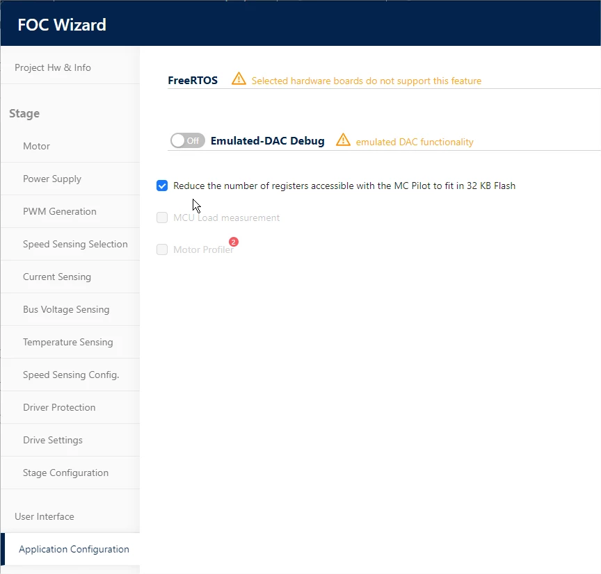

REVUp table setting through Motor Pilot feature is not available for all boards (STSPIN3202 e.g) due to memory footprint constraint.
If feature is not available you will have an error visible on Pilot logs tab.
Please check
If it is the case, un-select box and select in register_interface.c file, the necessary commands for your use case that fits in available memory.

I checked the points you mentioned.
The values I try to enter should be valid.
For reference, I'm using the Nucleo-G431RB controller board together with the X-NUCLEO-IHM08M1 power stage.
A BLDC motor with max current of 12A is used.

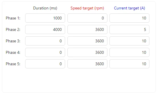

In the MC Workbench the Rev-Up values are set as follows:
The first issue now is that in the Motor Pilot, the values already show up slightly wrong:
Now when I change the Torque value of Phase 1 to "2" (or 2.000, doesn't matter) for 2A, press enter to apply the value and then press "Read parameters", the Torque of Phase 1 is now 0 and can't be changed to anything else until I power-cycle the device. Same happens for the other Torque values.
I can change the other values (Duration, Speed) just fine, there's only some rounding errors applied there.

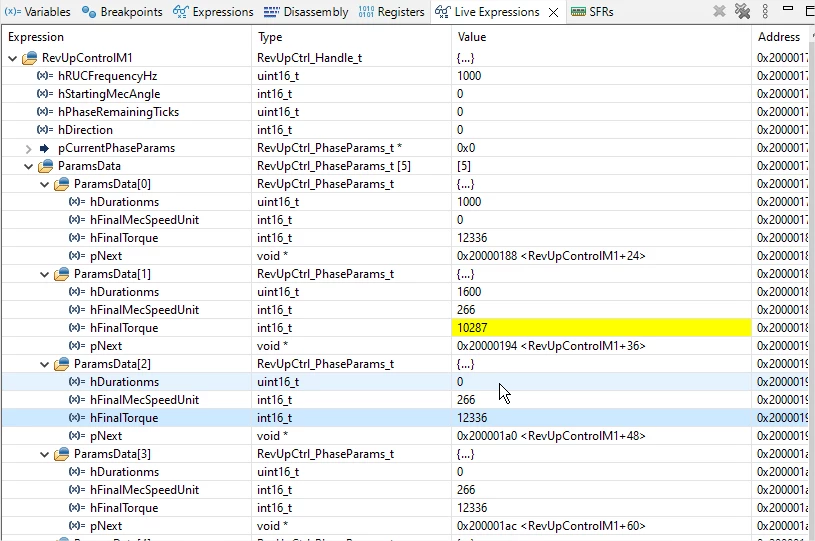

The slight difference on Torque target values comes FW internal conversion from Amps to s16Amps, and Pilot conversion from s16Amps reported by FW to Amps for Pilot GUI interface.
With Nucleo-G431RB/X-NUCLEO-IHM08M1/Dummy motor with max current = 12A on WB6.2.1 and Pilot1.2.5, values are correctly taken into account within allowed range.
As soon, the hFinalTorque value in RevUpControlM1 struct becomes negative (high values not correctly handled on our side), I see the negative value appearing on Pilot GUI, and set to zero when I click on the box.

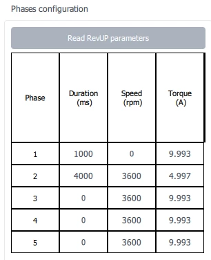

At least using the MotorPilot tool in version 6.3.0 did not fix this issue.
I'll wait for an updated version of it that hopefully implements the locales fix mentioned in the other thread.

December 6, 2024
Same problem here, can't seem to be able to write the TORQUE values. Any change sets them to 0 resulting in the parameters reading out 0 again from the controller side.
Using MC Workbench 6.3.2
Using the IHM03 kit with the Nucleo-G431RB and X-NUCLEO-IHM16M1 power board.
