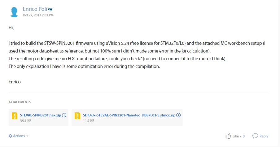

Enrico Poli
Posted on October 27, 2017 at 15:03
I tried to build the STSW-SPIN3201 firmware using uVision 5.24 (free license for STM32F0/L0) and the attached MC workbench setup (I used the motor datasheet as reference, but not 100% sure I didn't made some error in the ke calculation).
The resulting code give me no FOC duration failure, could you check? (no need to connect it to the motor I think).
The onlyexplanation I have is some optimization error during the compilation.
Enrico

Max Schachtschabel
Posted on October 30, 2017 at 09:30
and the attached MC workbench Setup
Sorry, but i could not find any attachement in your reply (how DO you upload something in a post here?)...
could you send it to me via E-Mail?
-M
Enrico Poli
Posted on October 30, 2017 at 10:09
The attachments should be visible in the bottom of my reply.
You can upload attachments using the advanced editor (upper right corner in the reply box).
