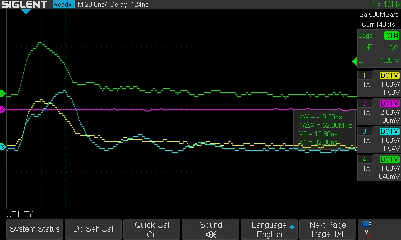

I believe that the wave forms going to the Gates is shown in this image, does this wave form look normal? The voltages are 2V at the peak but only about 10ns apart:

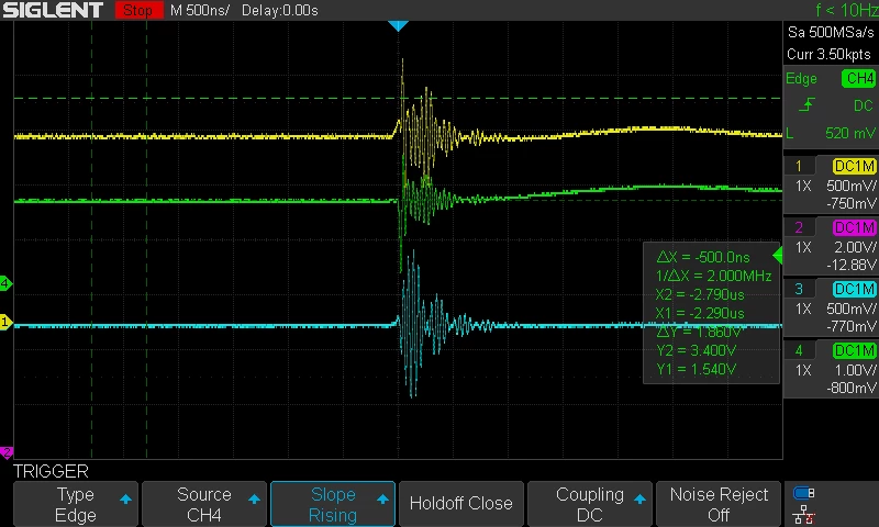

The phase currents are shown in this image:
All three phases are taking current.
No sensors
3 current sensors
I am thinking that I will need to change to a more suitable motor. The one I have is a bike motor that has 9 pole pairs and a max RPM of 285.

The Profiler's behavior is startling me, is the motor spinning but the Profiling never stops or is the motor staying put and the profiling bar stays at 0% ? Have you tried tinkering with the max speed and max current values to see if any improvement occurs ?
When I talk about the User Manual, I mean the one you can find via WorkBench, clicking on About -> Documentations -> Documentation. Then in the newly opened browser tab you should find Open loop description and usage.
Have you tried reducing the rev-up current before starting ?
