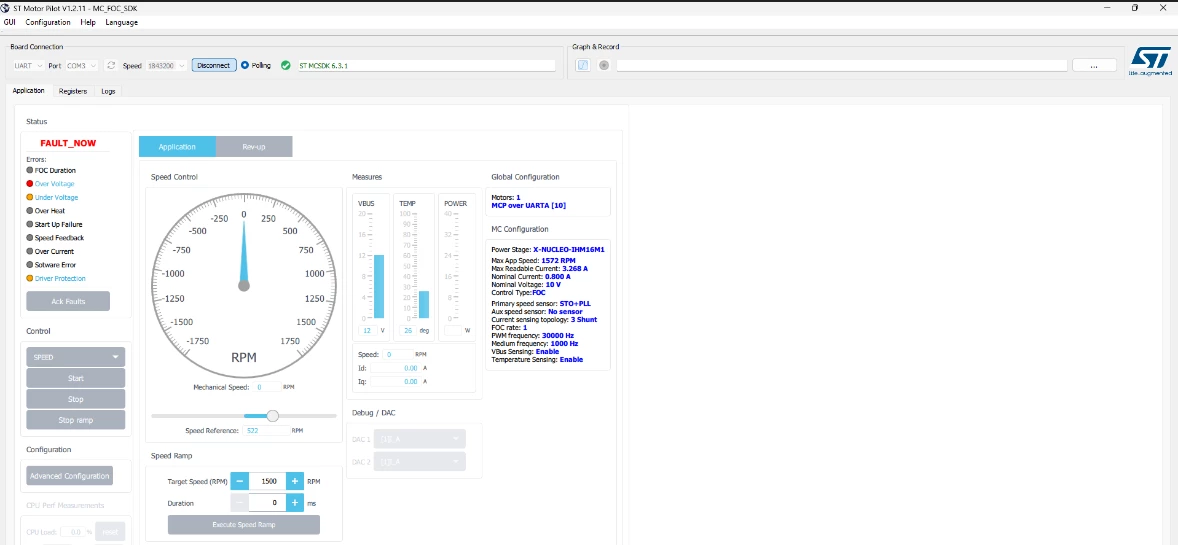

I possess the following items:
1. Development Board : P-NUCLEO-IHM03
2. Controller Board : NUCLEO-G431RB
3. Inverter Board : X-NUCLEO-IHM16M1
4. DC power supply 12 V dc
I downloaded the STM32 MCSDK 6.3.1 SDK as part of the environment setup, which is included with STM32CubelDE Version 1.16.1 and Motor Pilot_6.3.1 for monitoring purposes. Following the documentation's suggestion, I successfully generated the code for the specified hardware combination. After successfully building the generated code, I was able to flash it onto the controller. Upon powering up the development board, the motor pilot tool displayed the following status.
The status is triggered with FAULT_NOW with highlighting the following: Over Voltage, Under Voltage and Driver Protection.

    Hello @Prasanth91,
    Using P-NUCLEO-IHM03 from WB 6.3.1
    I have generated the code, and in Bus Voltage Sensing tab, you can increase the Over Voltage value to 14V (by default set 12V).

    The proposed solution effectively resolved my issue. Thanks for the support.
