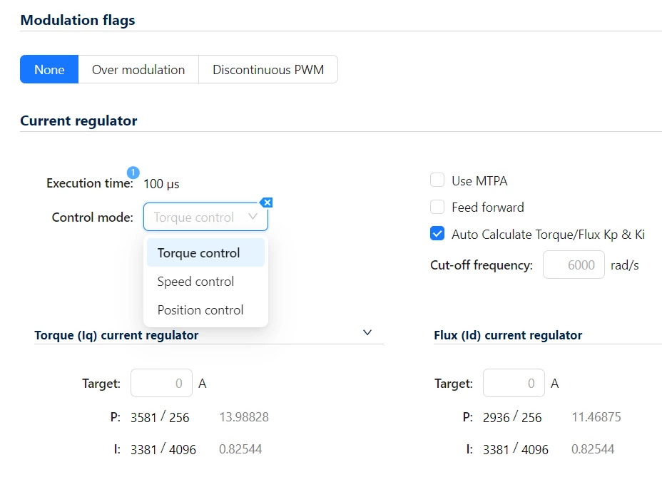

Issue-2: We do not understand which control mode to choose. There are 3 control mode namely, Torque Control, Speed Control and Position Control. So, what are the expectations from these control modes. Among Torque and Speed control mode there is no change/improvement observed for lower rpms issue. In Position control mode the lower rpms are better than the other two control modes but, the motor is vibrating, making noise and heating up.

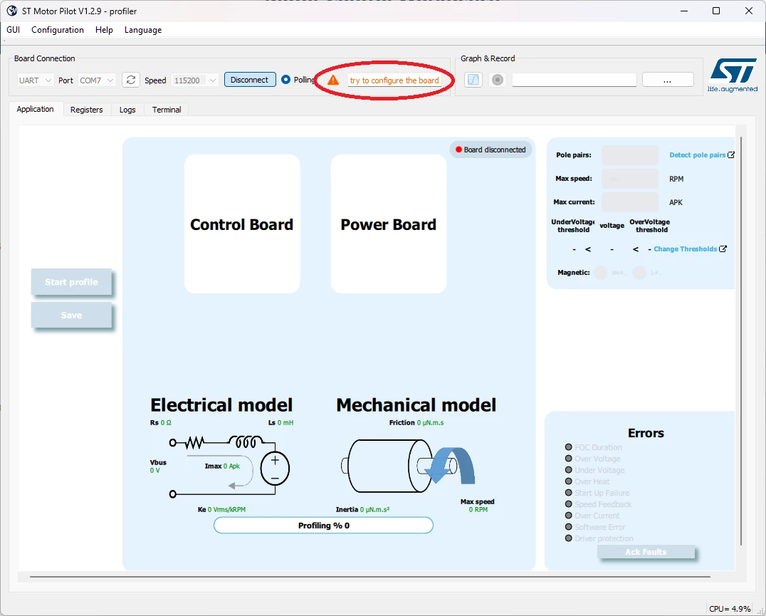

Issue-1: As mentioned in the Release Notes documentation available through "Workbench tool">About>Documentations>"Release Notes":
  • The Profiler requires an MCU equipped with an FPU. Therefore, it is not possible to generate a motor profiler firmware for the STM32F0, STM32G0 or STM32C0 families.
You can find guide lines for How To manually configure the motor parameters.
Issue-2: Speed or Torque mode depends on how you want to control the motor. Position Control mode is described in documentation available through "Workbench tool">About>Documentations>Documentation, "user Manual" tab, "Position control" link.

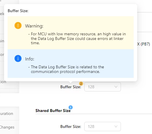

Issue-3: Graph is disable according to the unselected "Data Log" option by default:
If you enable it, take care of warning message: "For MCU with low memory resource, an high value in the Data Log Buffer Size could cause errors at linker time.".

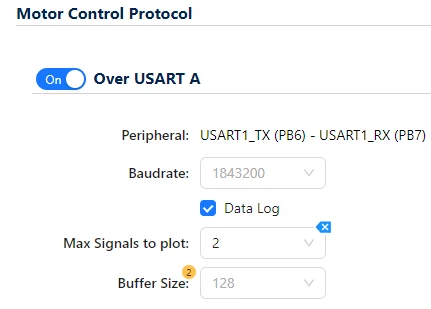

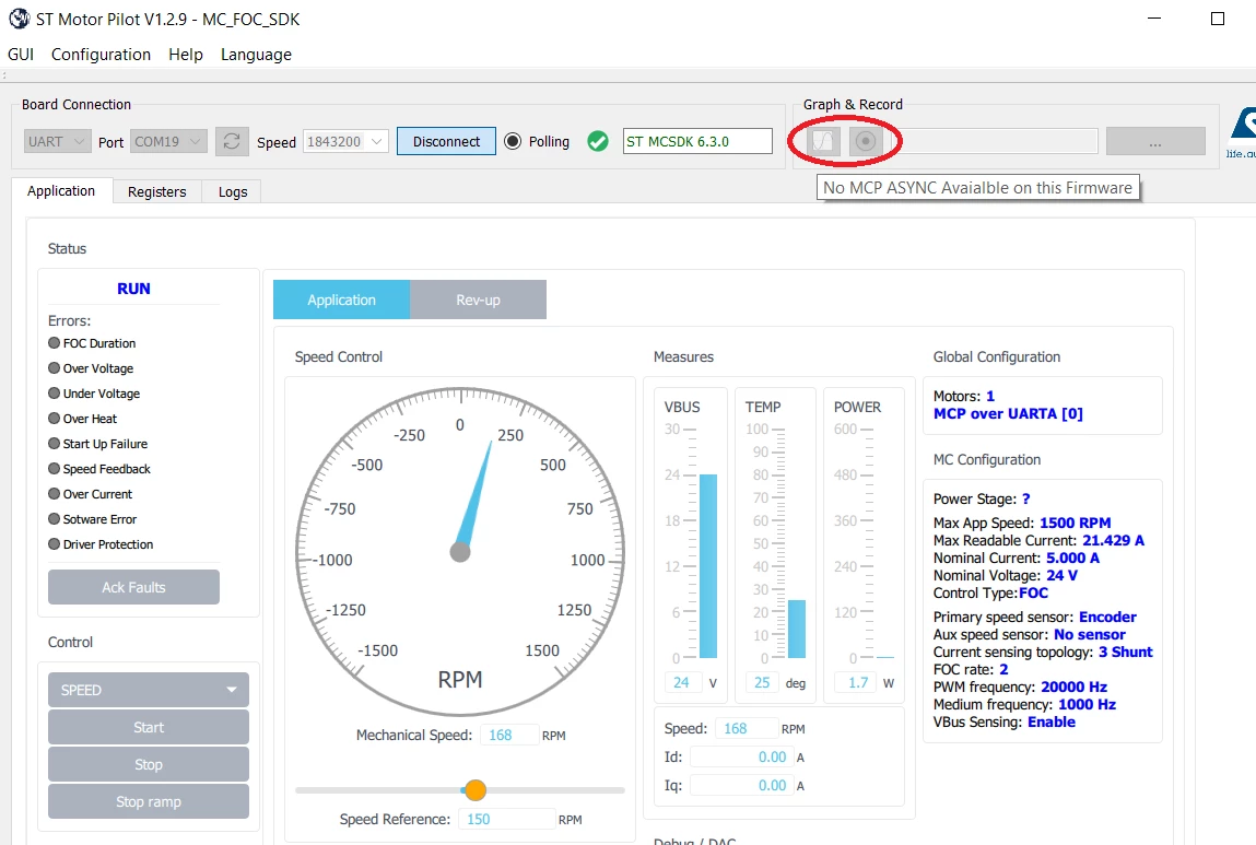

To enable the 'Graph & Record' option in the Motor Pilot, I enabled the 'Data Log' option.
Now, the 'Graph & Record' option is enabled in Motor Pilot but, when I am adding a signal to the graph it doesn't plot anything.
And, an error pops up at the bottom of the Motor Pilot window.
Is this because the following warning message?
If so, then the buffer size selected (128) is the minimum possible value.
Can you please suggest how can I add a signal to the plotter window in this scenario?

GMA
July 25, 2024
Hello @santosh-ametek,
Please try by de-selecting the "Reduce the number..." option.
If you agree with the answer, please accept it by clicking on 'Best answer'.Best regards.GMA

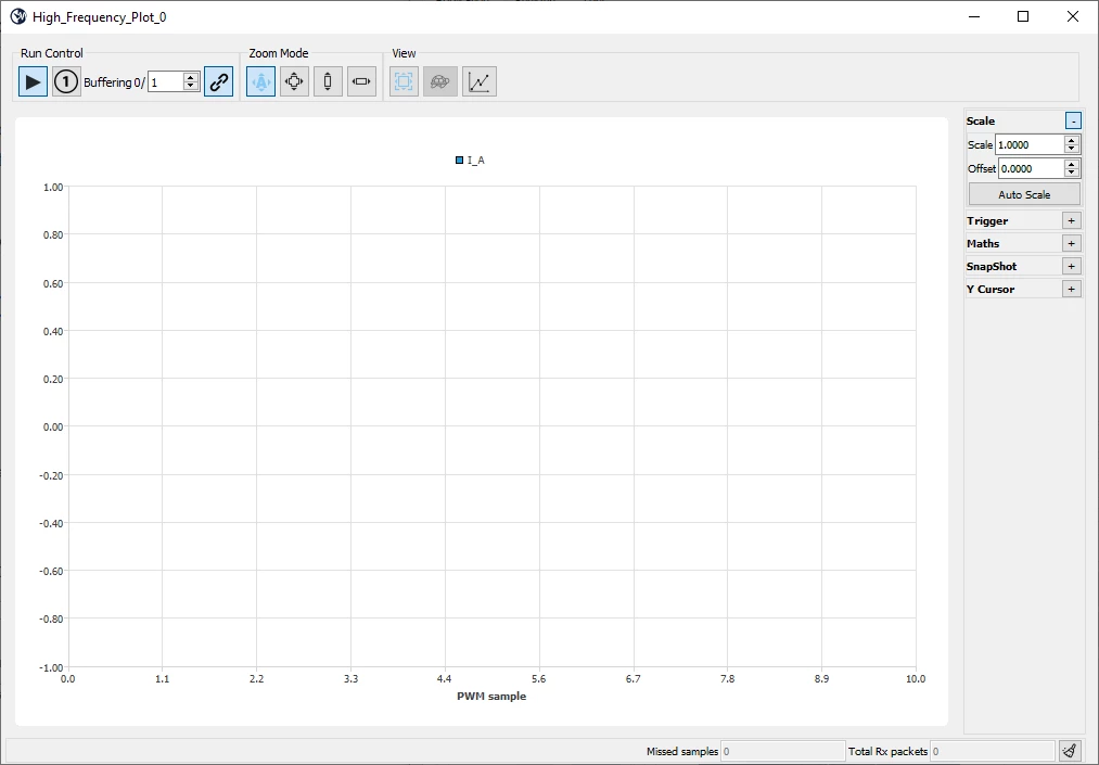

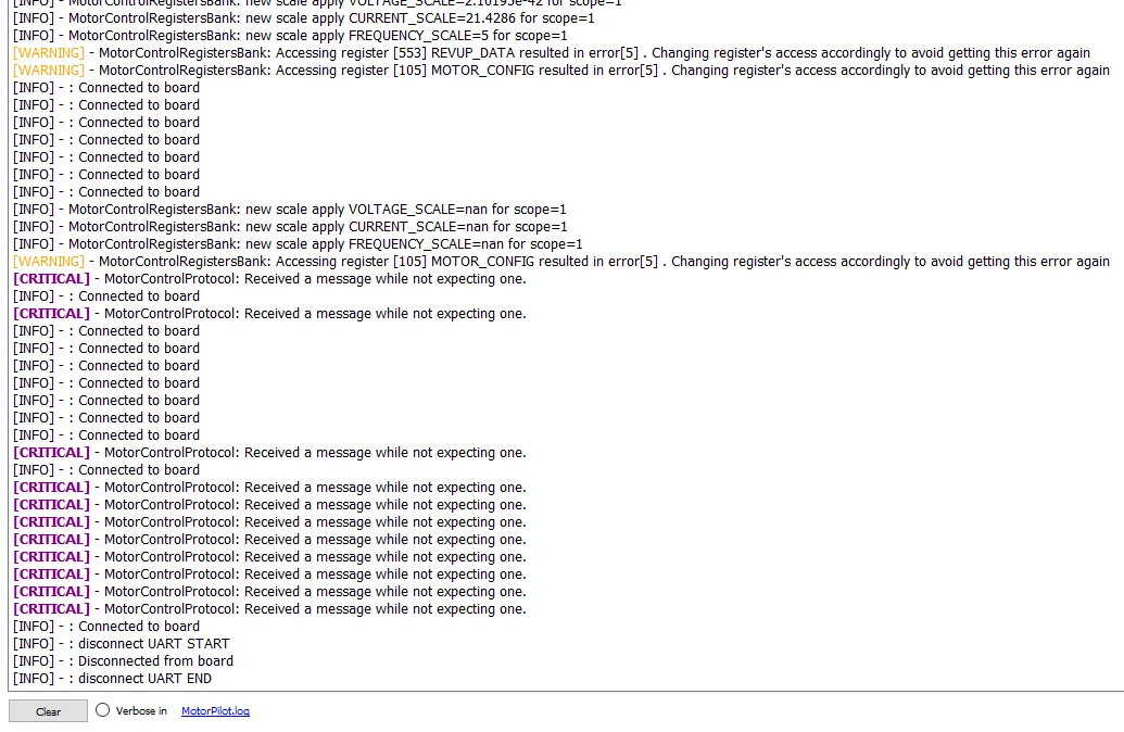

July 26, 2024
Hi @GMA
I tried by de-selecting the option you had mentioned.

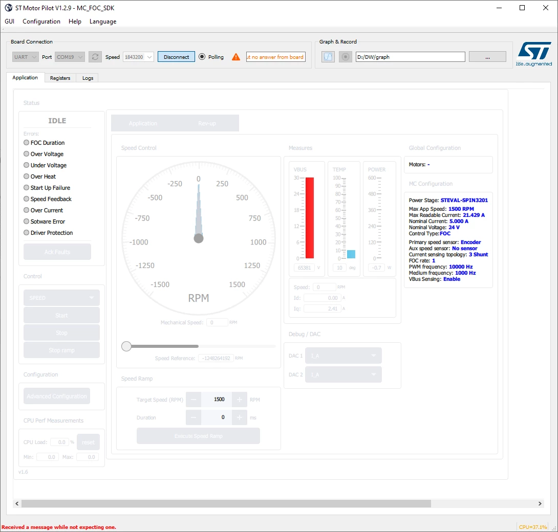

Now I could see the plot in the graph window, but I guess frequent connection/disconnection are happening so the plot is sometimes stopping and restarting..
The log window show some warnings too!
Sometimes Motor Pilot is not responding and plotter stops to plot signal!
Regards,
