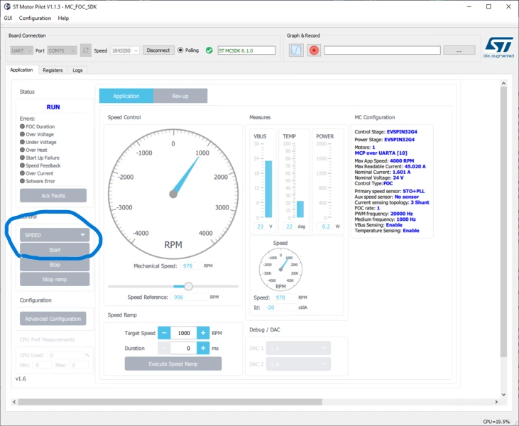

I am glad to learn that you managed to make your motor run. However, as you are in Torque Mode, it is normal that the motor tries to get to the maximum speed allowed by the target Torque. I suppose you did not input any load on your motor, so that maximum speed allowed would be the maximum speed of the motor.
To give you an exemple, let's say you input a target Torque of 5 N.m, and that there is no load on your motor, then your resistive Torque would be 0 N.m. Your system will then accelerate your motor until your resistive Torque reaches 5 N.m, but as it would only be the one of the induced by the shaft (usually almost zero although it depends on the motor) + friction (very low too), you end up never reaching 5 N.m. What happens next is that your system accelerates until it reaches the maximum allowed speed : the maximum speed of the motor.
You can try either to add some load on your motor shaft or to reduce drastically your target torque. Finally, to control speed, nothing beats Speed Mode. It is available by clicking on the SPEED / TORQUE button on top of the Start button in the control panel (see image)731px-STM32_MC_MotorPilot_slide4.png

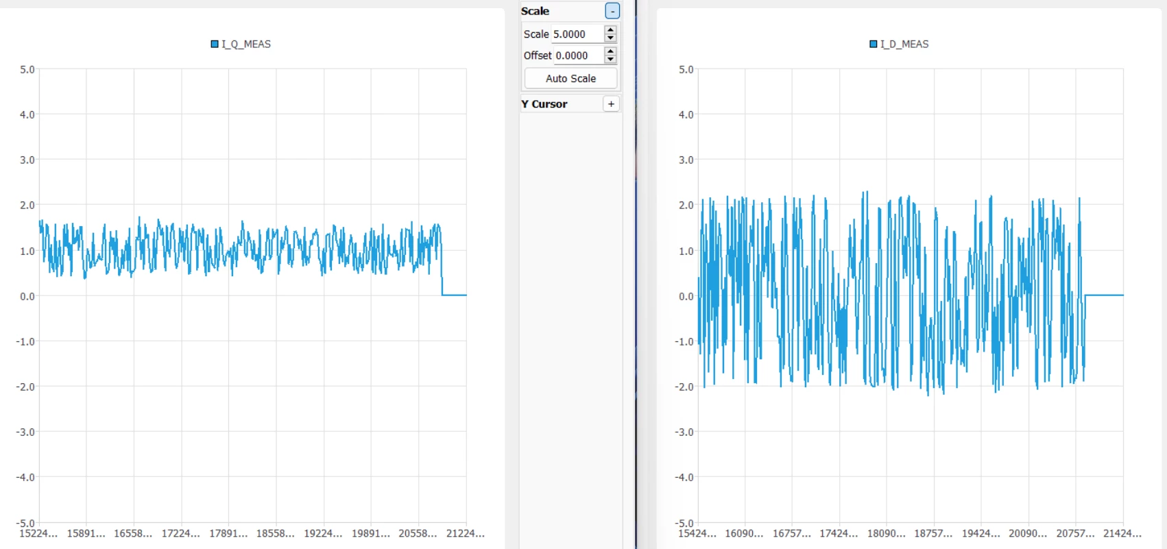

I had the controller on speed mode the entire time. Adjust the RPM on the dial does nothing. I also was monitoring the currents Id and Iq. Both waveforms have sharp peaks and valleys. I don't see how I can precisely control torque with these results. Although, I did notice some performance improvements when I was playing with the PI constants. This also adjusted the speed of the motor though the speed dial still did nothing.
