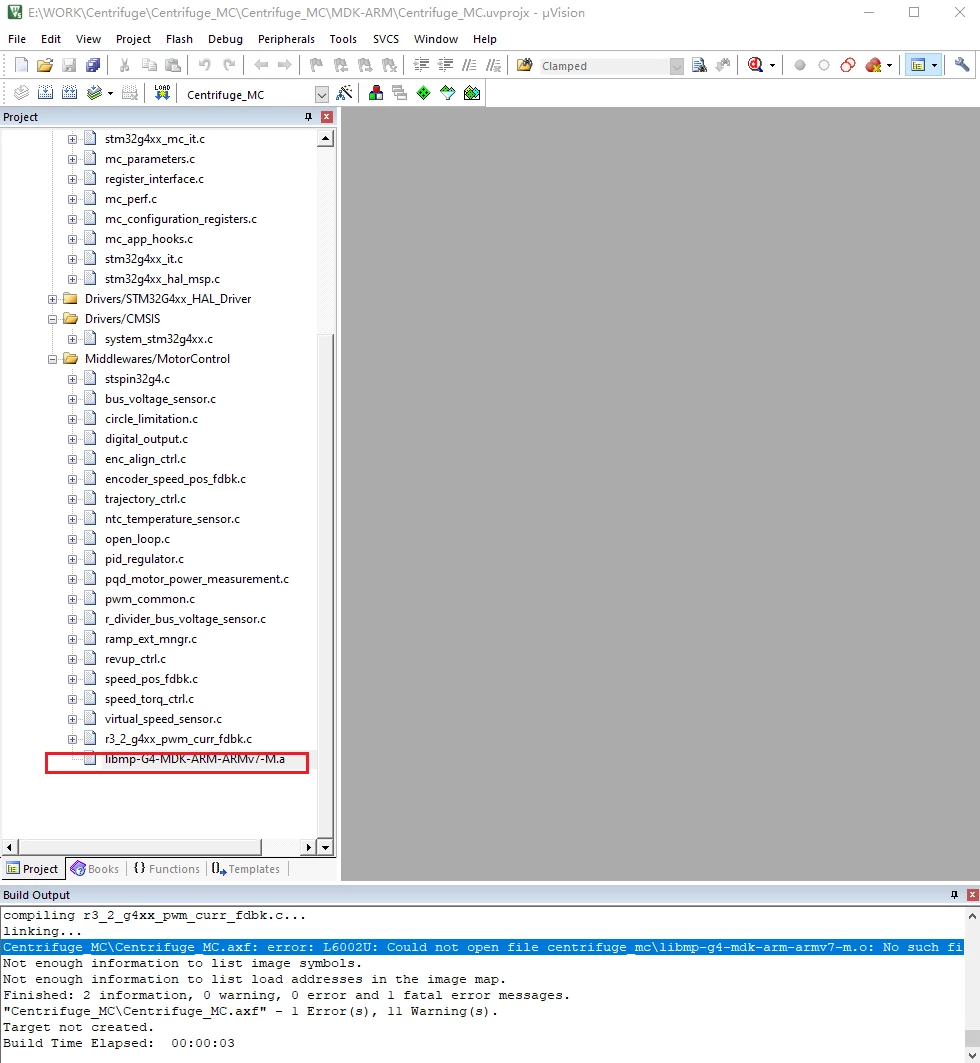

MDK6.2.1 Error in. a file not found after generating MDK5.32 environment code
  • January 30, 2024
  • 5 replies
  • 3906 views

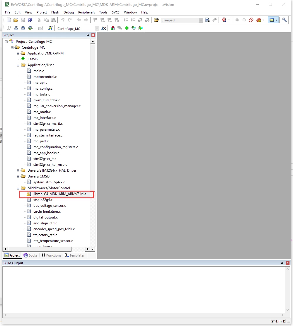

1.After generating the code, this. a file will directly display an exclamation mark;
2.I deleted this file again and then loaded it in. Compilation still reports errors.
3. The error message is as follows: There are no Chinese characters in the path.
Centrifuge_MC\Centrifuge_MC.axf: error: L6002U: Could not open file centrifuge_mc\libmp-g4-mdk-arm-armv7-m.o: No such file or directory
求解答。

    我重新试了一下,MC6.2.0的版本,生成没有问题。
    Visitor II
    February 19, 2024
    兄弟,刚刚我也出现这个问题,检查后发现找不到的这个库文件是因为生成的库文件名写错了。把 "MCSDK_v6.2.1-Full\MotorControl" 目录下的 "libmp-G4-MDK-ARM-ARMv7-M", 改为“libmp-G4-MDK-ARM_ARMv7-M”就能编译通过了。
    浚钱.1
    浚钱.1Author
    March 8, 2024
    哈哈,感谢感谢,我是把版本回退到6.2.0了,然后解决问题了。
    Visitor II
    April 24, 2024
    我把libmp-G4-MDK-ARM-ARMv7-M.a从工程中删除,也能编译成功,运行起来也正常啊
    看起来是冗余的库。
