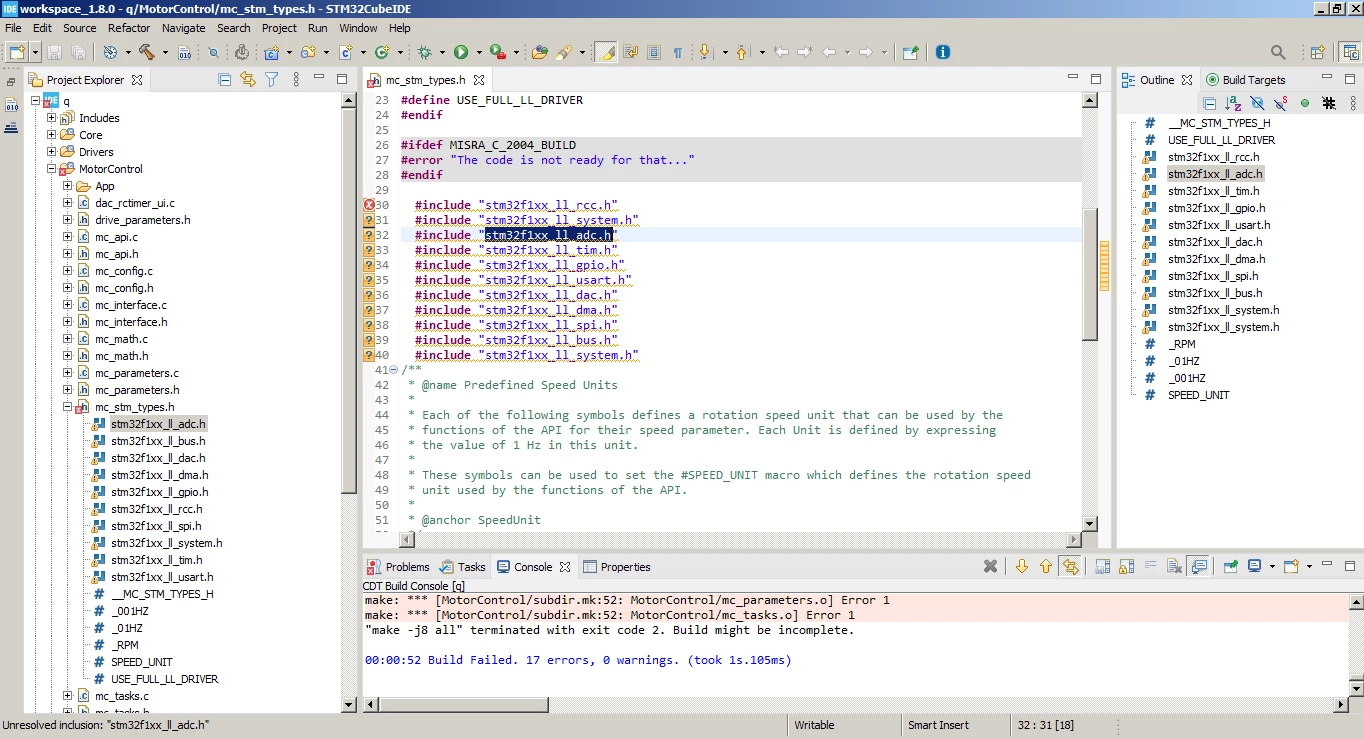

Im currently tring to program my nucleo-f103rb module. I have succesfully generated Motor control workbench project and CubeMx project. After code generation using cubemx , stm32cubeide1.8.0 opens the project code. Without changing anyting on the code , i pressed debug and 17 errors accured. I will share build console respons below.
Build console:
17:41:05 **** Incremental Build of configuration Debug for project stm32f103rb_son ****
make -j8 all
arm-none-eabi-gcc "../MotorControl/App/motorcontrol.c" -mcpu=cortex-m3 -std=gnu11 -g3 -DDEBUG -DUSE_HAL_DRIVER -DSTM32F103xB -c -I../MotorControl/App -I../MotorControl -I../Core/Inc -I../Drivers/STM32F1xx_HAL_Driver/Inc -I../Drivers/STM32F1xx_HAL_Driver/Inc/Legacy -I../MCSDK_v5.4.8-Full/MotorControl/MCSDK/MCLib/Any/Inc -I../MCSDK_v5.4.8-Full/MotorControl/MCSDK/MCLib/F1xx/Inc -I../MCSDK_v5.4.8-Full/MotorControl/MCSDK/UILibrary/Inc -I../MCSDK_v5.4.8-Full/MotorControl/MCSDK/SystemDriveParams -I../Drivers/CMSIS/Device/ST/STM32F1xx/Include -I../Drivers/CMSIS/Include -O0 -ffunction-sections -fdata-sections -Wall -fstack-usage -MMD -MP -MF"MotorControl/App/motorcontrol.d" -MT"MotorControl/App/motorcontrol.o" --specs=nano.specs -mfloat-abi=soft -mthumb -o "MotorControl/App/motorcontrol.o"
arm-none-eabi-gcc "../MotorControl/dac_rctimer_ui.c" -mcpu=cortex-m3 -std=gnu11 -g3 -DDEBUG -DUSE_HAL_DRIVER -DSTM32F103xB -c -I../MotorControl/App -I../MotorControl -I../Core/Inc -I../Drivers/STM32F1xx_HAL_Driver/Inc -I../Drivers/STM32F1xx_HAL_Driver/Inc/Legacy -I../MCSDK_v5.4.8-Full/MotorControl/MCSDK/MCLib/Any/Inc -I../MCSDK_v5.4.8-Full/MotorControl/MCSDK/MCLib/F1xx/Inc -I../MCSDK_v5.4.8-Full/MotorControl/MCSDK/UILibrary/Inc -I../MCSDK_v5.4.8-Full/MotorControl/MCSDK/SystemDriveParams -I../Drivers/CMSIS/Device/ST/STM32F1xx/Include -I../Drivers/CMSIS/Include -O0 -ffunction-sections -fdata-sections -Wall -fstack-usage -MMD -MP -MF"MotorControl/dac_rctimer_ui.d" -MT"MotorControl/dac_rctimer_ui.o" --specs=nano.specs -mfloat-abi=soft -mthumb -o "MotorControl/dac_rctimer_ui.o"
arm-none-eabi-gcc "../MotorControl/mc_api.c" -mcpu=cortex-m3 -std=gnu11 -g3 -DDEBUG -DUSE_HAL_DRIVER -DSTM32F103xB -c -I../MotorControl/App -I../MotorControl -I../Core/Inc -I../Drivers/STM32F1xx_HAL_Driver/Inc -I../Drivers/STM32F1xx_HAL_Driver/Inc/Legacy -I../MCSDK_v5.4.8-Full/MotorControl/MCSDK/MCLib/Any/Inc -I../MCSDK_v5.4.8-Full/MotorControl/MCSDK/MCLib/F1xx/Inc -I../MCSDK_v5.4.8-Full/MotorControl/MCSDK/UILibrary/Inc -I../MCSDK_v5.4.8-Full/MotorControl/MCSDK/SystemDriveParams -I../Drivers/CMSIS/Device/ST/STM32F1xx/Include -I../Drivers/CMSIS/Include -O0 -ffunction-sections -fdata-sections -Wall -fstack-usage -MMD -MP -MF"MotorControl/mc_api.d" -MT"MotorControl/mc_api.o" --specs=nano.specs -mfloat-abi=soft -mthumb -o "MotorControl/mc_api.o"
arm-none-eabi-gcc "../MotorControl/mc_config.c" -mcpu=cortex-m3 -std=gnu11 -g3 -DDEBUG -DUSE_HAL_DRIVER -DSTM32F103xB -c -I../MotorControl/App -I../MotorControl -I../Core/Inc -I../Drivers/STM32F1xx_HAL_Driver/Inc -I../Drivers/STM32F1xx_HAL_Driver/Inc/Legacy -I../MCSDK_v5.4.8-Full/MotorControl/MCSDK/MCLib/Any/Inc -I../MCSDK_v5.4.8-Full/MotorControl/MCSDK/MCLib/F1xx/Inc -I../MCSDK_v5.4.8-Full/MotorControl/MCSDK/UILibrary/Inc -I../MCSDK_v5.4.8-Full/MotorControl/MCSDK/SystemDriveParams -I../Drivers/CMSIS/Device/ST/STM32F1xx/Include -I../Drivers/CMSIS/Include -O0 -ffunction-sections -fdata-sections -Wall -fstack-usage -MMD -MP -MF"MotorControl/mc_config.d" -MT"MotorControl/mc_config.o" --specs=nano.specs -mfloat-abi=soft -mthumb -o "MotorControl/mc_config.o"
arm-none-eabi-gcc "../MotorControl/mc_interface.c" -mcpu=cortex-m3 -std=gnu11 -g3 -DDEBUG -DUSE_HAL_DRIVER -DSTM32F103xB -c -I../MotorControl/App -I../MotorControl -I../Core/Inc -I../Drivers/STM32F1xx_HAL_Driver/Inc -I../Drivers/STM32F1xx_HAL_Driver/Inc/Legacy -I../MCSDK_v5.4.8-Full/MotorControl/MCSDK/MCLib/Any/Inc -I../MCSDK_v5.4.8-Full/MotorControl/MCSDK/MCLib/F1xx/Inc -I../MCSDK_v5.4.8-Full/MotorControl/MCSDK/UILibrary/Inc -I../MCSDK_v5.4.8-Full/MotorControl/MCSDK/SystemDriveParams -I../Drivers/CMSIS/Device/ST/STM32F1xx/Include -I../Drivers/CMSIS/Include -O0 -ffunction-sections -fdata-sections -Wall -fstack-usage -MMD -MP -MF"MotorControl/mc_interface.d" -MT"MotorControl/mc_interface.o" --specs=nano.specs -mfloat-abi=soft -mthumb -o "MotorControl/mc_interface.o"
arm-none-eabi-gcc "../MotorControl/mc_math.c" -mcpu=cortex-m3 -std=gnu11 -g3 -DDEBUG -DUSE_HAL_DRIVER -DSTM32F103xB -c -I../MotorControl/App -I../MotorControl -I../Core/Inc -I../Drivers/STM32F1xx_HAL_Driver/Inc -I../Drivers/STM32F1xx_HAL_Driver/Inc/Legacy -I../MCSDK_v5.4.8-Full/MotorControl/MCSDK/MCLib/Any/Inc -I../MCSDK_v5.4.8-Full/MotorControl/MCSDK/MCLib/F1xx/Inc -I../MCSDK_v5.4.8-Full/MotorControl/MCSDK/UILibrary/Inc -I../MCSDK_v5.4.8-Full/MotorControl/MCSDK/SystemDriveParams -I../Drivers/CMSIS/Device/ST/STM32F1xx/Include -I../Drivers/CMSIS/Include -O0 -ffunction-sections -fdata-sections -Wall -fstack-usage -MMD -MP -MF"MotorControl/mc_math.d" -MT"MotorControl/mc_math.o" --specs=nano.specs -mfloat-abi=soft -mthumb -o "MotorControl/mc_math.o"
arm-none-eabi-gcc "../MotorControl/mc_parameters.c" -mcpu=cortex-m3 -std=gnu11 -g3 -DDEBUG -DUSE_HAL_DRIVER -DSTM32F103xB -c -I../MotorControl/App -I../MotorControl -I../Core/Inc -I../Drivers/STM32F1xx_HAL_Driver/Inc -I../Drivers/STM32F1xx_HAL_Driver/Inc/Legacy -I../MCSDK_v5.4.8-Full/MotorControl/MCSDK/MCLib/Any/Inc -I../MCSDK_v5.4.8-Full/MotorControl/MCSDK/MCLib/F1xx/Inc -I../MCSDK_v5.4.8-Full/MotorControl/MCSDK/UILibrary/Inc -I../MCSDK_v5.4.8-Full/MotorControl/MCSDK/SystemDriveParams -I../Drivers/CMSIS/Device/ST/STM32F1xx/Include -I../Drivers/CMSIS/Include -O0 -ffunction-sections -fdata-sections -Wall -fstack-usage -MMD -MP -MF"MotorControl/mc_parameters.d" -MT"MotorControl/mc_parameters.o" --specs=nano.specs -mfloat-abi=soft -mthumb -o "MotorControl/mc_parameters.o"
arm-none-eabi-gcc "../MotorControl/mc_tasks.c" -mcpu=cortex-m3 -std=gnu11 -g3 -DDEBUG -DUSE_HAL_DRIVER -DSTM32F103xB -c -I../MotorControl/App -I../MotorControl -I../Core/Inc -I../Drivers/STM32F1xx_HAL_Driver/Inc -I../Drivers/STM32F1xx_HAL_Driver/Inc/Legacy -I../MCSDK_v5.4.8-Full/MotorControl/MCSDK/MCLib/Any/Inc -I../MCSDK_v5.4.8-Full/MotorControl/MCSDK/MCLib/F1xx/Inc -I../MCSDK_v5.4.8-Full/MotorControl/MCSDK/UILibrary/Inc -I../MCSDK_v5.4.8-Full/MotorControl/MCSDK/SystemDriveParams -I../Drivers/CMSIS/Device/ST/STM32F1xx/Include -I../Drivers/CMSIS/Include -O0 -ffunction-sections -fdata-sections -Wall -fstack-usage -MMD -MP -MF"MotorControl/mc_tasks.d" -MT"MotorControl/mc_tasks.o" --specs=nano.specs -mfloat-abi=soft -mthumb -o "MotorControl/mc_tasks.o"
In file included from ../MCSDK_v5.4.8-Full/MotorControl/MCSDK/MCLib/Any/Inc/mc_type.h:56,
from ../MotorControl/user_interface.h:31,
from ../MCSDK_v5.4.8-Full/MotorControl/MCSDK/UILibrary/Inc/dac_rctimer_ui.h:25,
from ../MotorControl/dac_rctimer_ui.c:26:
../MotorControl/mc_stm_types.h:30:12: fatal error: stm32f1xx_ll_rcc.h: No such file or directory
30 | #include "stm32f1xx_ll_rcc.h"
compilation terminated.
make: *** [MotorControl/subdir.mk:52: MotorControl/dac_rctimer_ui.o] Error 1
make: *** Waiting for unfinished jobs....
from ../MotorControl/mc_interface.h:31,
from ../MotorControl/mc_api.c:20:
from ../MotorControl/mc_math.h:28,
from ../MotorControl/mc_interface.c:24:
make: *** [MotorControl/subdir.mk:52: MotorControl/mc_api.o] Error 1
from ../MotorControl/mc_math.c:22:
make: *** [MotorControl/subdir.mk:52: MotorControl/mc_interface.o] Error 1
make: *** [MotorControl/subdir.mk:52: MotorControl/mc_math.o] Error 1
from ../MCSDK_v5.4.8-Full/MotorControl/MCSDK/MCLib/Any/Inc/pid_regulator.h:27,
from ../MotorControl/mc_config.h:24,
from ../MotorControl/App/motorcontrol.h:24,
from ../Core/Inc/main.h:31,
from ../MotorControl/App/motorcontrol.c:19:
make: *** [MotorControl/App/subdir.mk:19: MotorControl/App/motorcontrol.o] Error 1
from ../MotorControl/mc_parameters.c:24:
from ../MotorControl/mc_config.c:19:
make: *** [MotorControl/subdir.mk:52: MotorControl/mc_config.o] Error 1
make: *** [MotorControl/subdir.mk:52: MotorControl/mc_parameters.o] Error 1
from ../MotorControl/mc_tasks.c:23:
make: *** [MotorControl/subdir.mk:52: MotorControl/mc_tasks.o] Error 1
"make -j8 all" terminated with exit code 2. Build might be incomplete.
17:41:06 Build Failed. 17 errors, 0 warnings. (took 644ms)
I had using old version of stm32cubeide and today i deleted old one and installed newer version 1.8.0 becuase i saw this errors. I thought newer version will solve this but no luck. I m using;
MotorControl Workbench 5.4.8
STM32CubeMX  version 6.4.0
STM32CubeIDE 1.8.0
with win 7 os.
Please help.

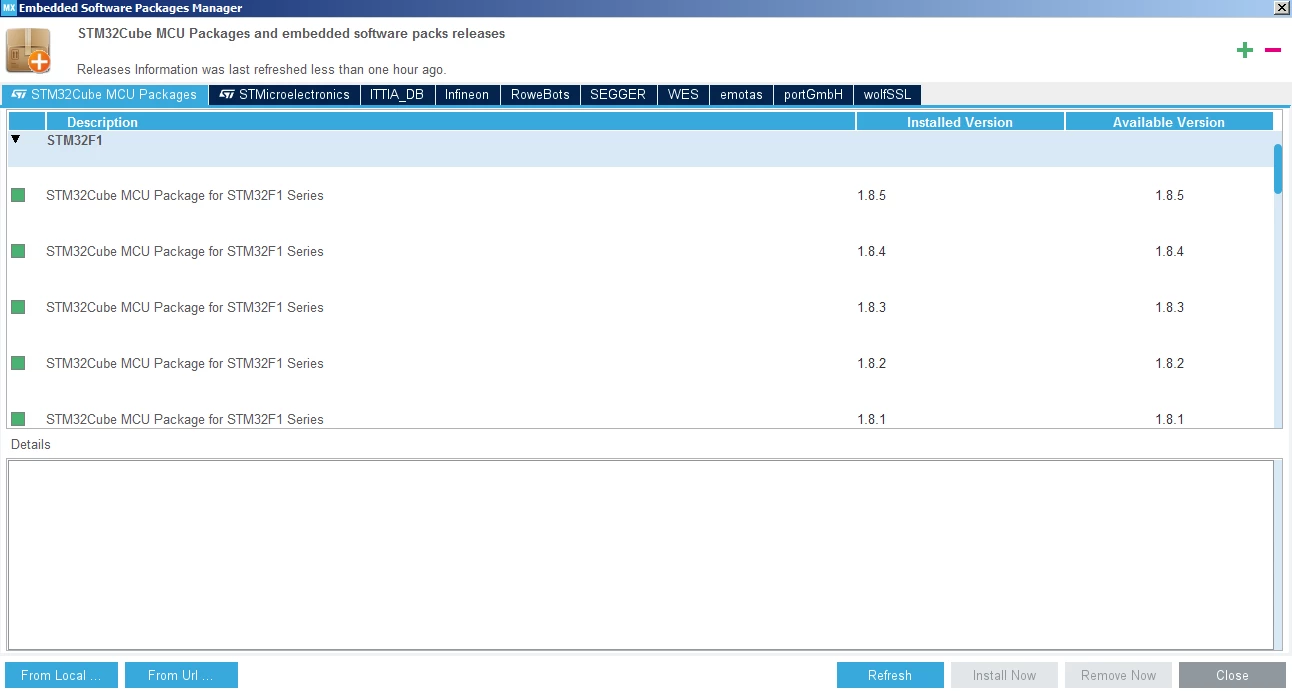

    GMA
    March 18, 2024
    Could you please check that a Firmware Package Version is available when generating project:
    You can download it through CubeMx>Help>"Manage embedded software packages">STM32F1
    stm32f1xx_ll_rcc.h should be present in "Project\Drivers\STM32F1xx_HAL_Driver\Inc" directory.
    If you agree with the answer, please accept it by clicking on 'Best answer'.Best regards.GMA

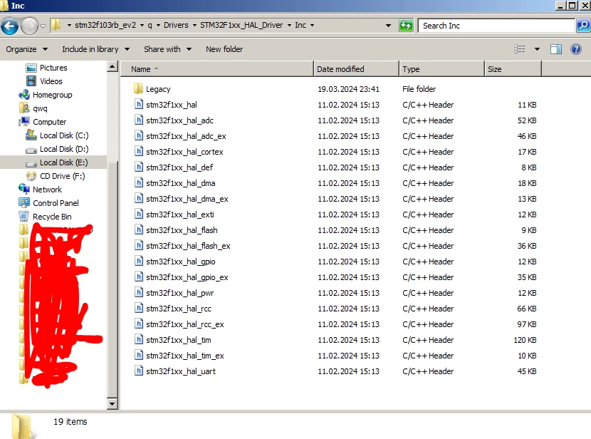

    qqwq.1
    qqwq.1Author
    March 19, 2024

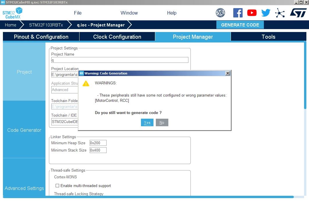

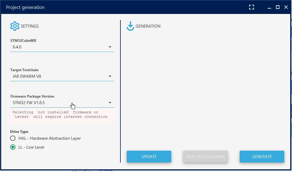

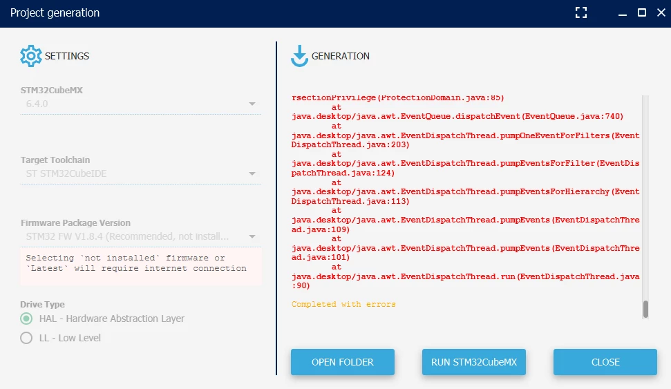

    Hi.
    I just check it and there are some other problems about generating and debuggin.
    Firstly when generation project using motor control workbench 5.4.8 software gives some error about java . I will share here screenshot and complete error code.
    here is the complete output data of the errors;
    2024-03-19 23:39:02,726 ERROR [LineInfo_to_exitCode.log_LineInfo] The ST intranet updater server is unknown: mcucrossselector.codex.cro.st.com
    2024-03-19 23:39:33,122 ERROR [LineInfo_to_exitCode.log_LineInfo] java.lang.IndexOutOfBoundsException: Index 0 out of bounds for length 0

    Those are only error outputs from project generation screen of mcsdk. It completes with error. Anyway when i with Run CubeMX , its opening and all pins are correct.
    Without changing anything on the CubeMX and after type name of project and select output for STM32CubeIDE , i click to generate button. After that event , an error massage pops up and says;
    After your succestion i have check the firmwares on the cubemx and 1.8.5 and 1.8.4 was already installed. For tring to find solution i also installed other firmware down to version 1.8.0. When i select to install version 1.8.0 , it tried to download and install but it gave and error message which it says, this version is already installed. you can see installed firmwares below;

    My cubeIDE is 1.8.0 version. Without changing anything on the code , i pressed the Debug button and 17 errors dissaperad. You can see below;
    It seems when generating files , some files are missing or something. Also you can see the file that you have mentioned your last post below ;
    Please help me for this. I cannot upload my code to the Nucleo board.
