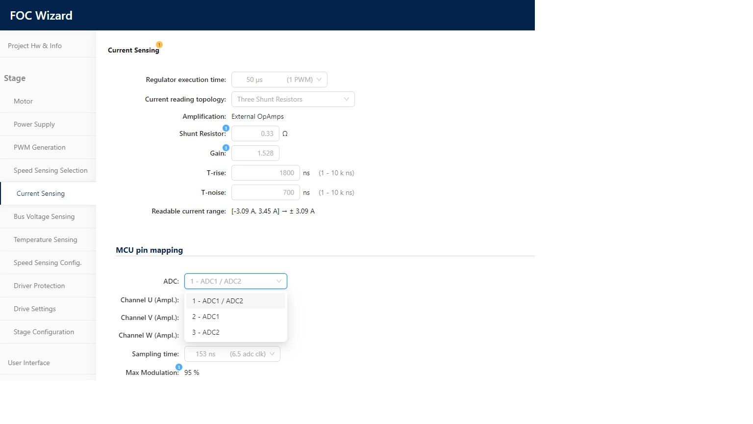

GMA
Jun 30, 2026 12:33 PM UTC
Hello ​@prathmeshpatil06,
In the Current sensing tab, select the single ADC topology (ADC1 should be available in the use case).
If you agree with the answer, please accept it by clicking on 'Best answer'.Best regards.GMA
GMA
Jun 30, 2026 1:56 PM UTC
The workbench always checks both three-shunt single-ADC and dual-ADC topologies.
Warnings can be ignored.
In the use case, neither overcurrent protection nor driver protection is available.
Connect the power-board driver fault signal to the break input of the control board PWM timer (refer to the Single error trigger hardware variant chapter).
