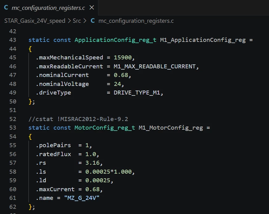

The generated project contains motor and drive parameters in:
- pmsm_motor_parameters.h
- drive_parameters.h
- power_stage_parameters.h
- parameters_conversion.h
Most runtime configuration correctly uses these macros or derived macros.
However, mc_configuration_registers.c duplicates several motor parameters as numeric literals in ApplicationConfig_reg_t and MotorConfig_reg_t, even though this file already includes parameters_conversion.h.
Examples from one generated project:
- maxMechanicalSpeed = 15900
  duplicates MOTOR_MAX_SPEED_RPM / MAX_APPLICATION_SPEED_RPM
- nominalCurrent = 0.68
  duplicates NOMINAL_CURRENT_A
- nominalVoltage = 24
  duplicates NOMINAL_BUS_VOLTAGE_V
- polePairs = 1
  duplicates POLE_PAIR_NUM
- ratedFlux = 0.8
  duplicates MOTOR_VOLTAGE_CONSTANT
- rs = 3.16
  duplicates RS
- ls = 0.00025 and ld = 0.00025
  duplicate or derive from LS
- maxCurrent = 0.68
  duplicates the configured motor current limit
These structures are compiled into the firmware and returned through MCP using
MC_REG_APPLICATION_CONFIG and MC_REG_MOTOR_CONFIG. Therefore, they are not only
code-generation intermediate data; they are user-visible Motor Pilot metadata.

1. Initialize ApplicationConfig_reg_t and MotorConfig_reg_t using the same generated
   parameter macros used by the runtime configuration.
2. Generate a single typed motor-configuration object and derive both runtime
   configuration and MCP metadata from it.
3. If literals are required by the generator architecture, add a generation-time
   consistency check and document the authoritative source and conversion rules.
Parameters with different meanings, such as rated motor current, Iq limit and
alignment current, should remain independently configurable. The request concerns
duplicated representations of the same semantic parameter, not merely equal numeric
values with different meanings.

6. Check sync_registers.c: the structures are returned for
I can provide a minimal STWB6 project and the generated files if needed.

GMA
Aug 5, 2026 8:01 AM UTC
Hello ​@Junde,
Could you please share your STWB6 project?
If you agree with the answer, please accept it by clicking on 'Best answer'.Best regards.GMA

GMA
Aug 7, 2026 3:32 PM UTC
Hello ​@Junde,
Thank you for the reporting.
The point has been escalated to dev team under internal ticket: CDM0064982
