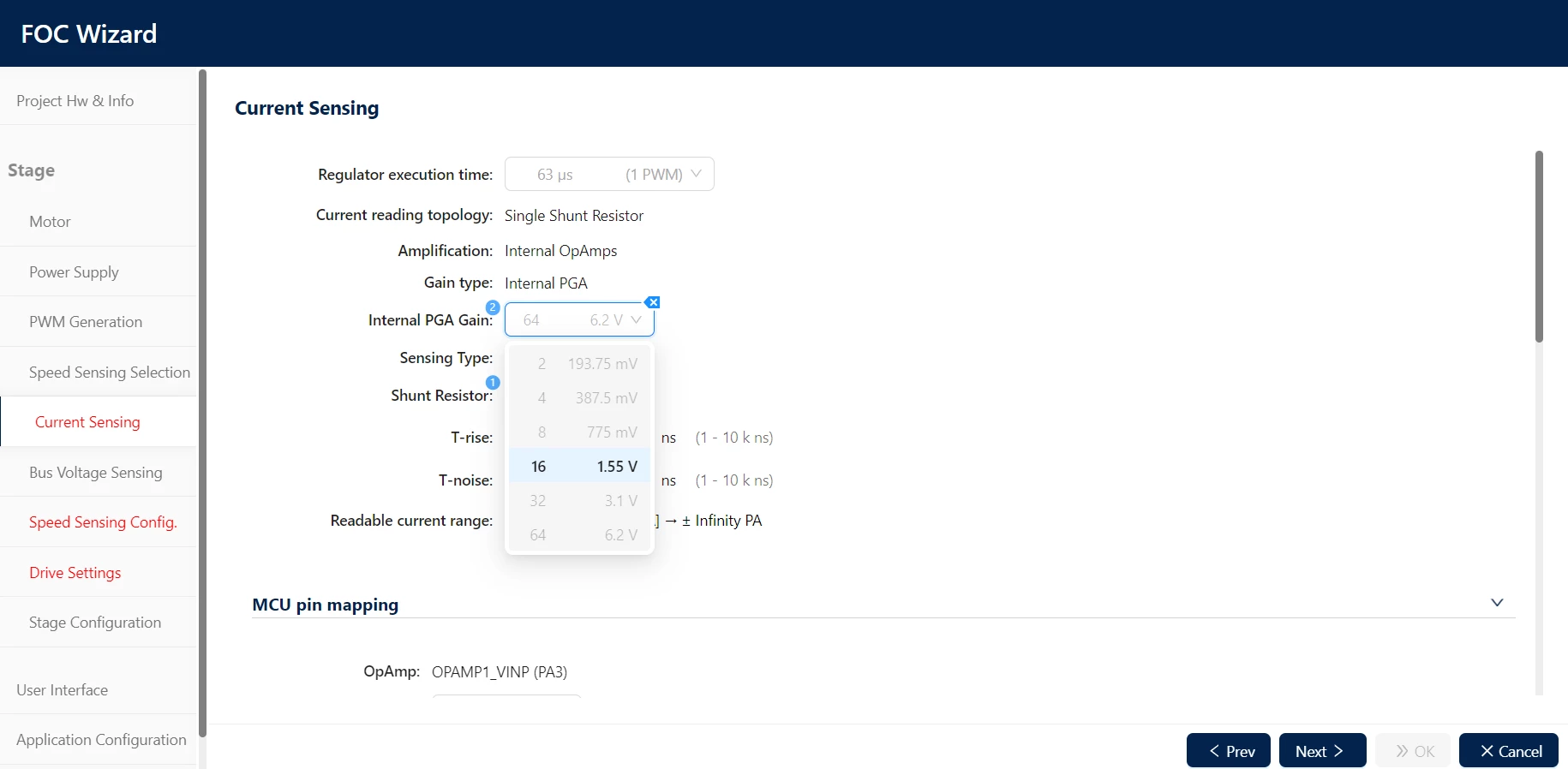

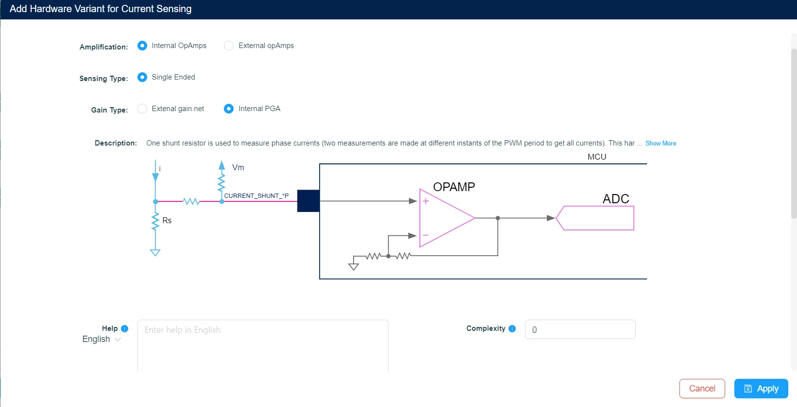

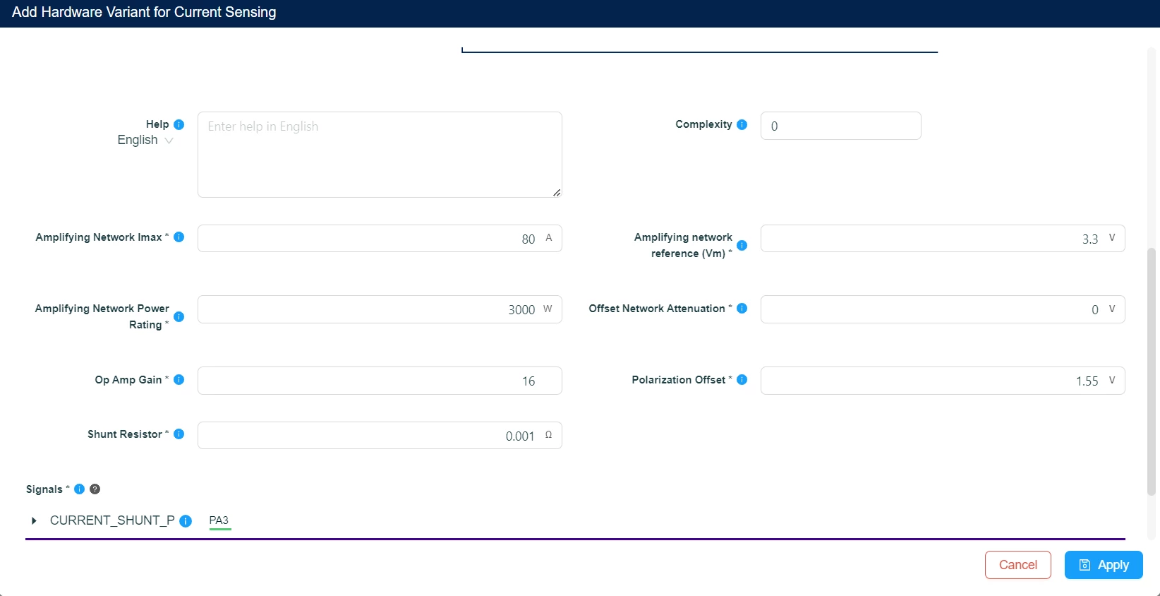

I am using MCSDK 6.4.1 to create my custom inverter board. I have configured the internal Op-amp's PGA gain.
However, when I load the configuration into the MCSDK project, it is not detected, and I am unable to select a gain of 16.
MCSDK doesn't recognize my board config, and it doesn't calculate the current range.
If it's not MCSDK that's wrong, please help me fix my wrong config
Thank you.

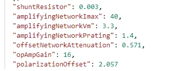

I assume you have to provide the offset network attenuation sample from ST board as below
GMA
September 23, 2025
Hello @VPTEK,
Can you share your json custom board file?
