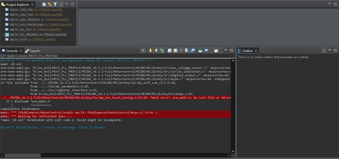

MCSDK 6.3.2 GenerateCode error about include path
I created a project based on PLL+Profile,  when compile the project, I get a ERROR, about include path. I search the file and add the path(../../Drivers/CMSIS/DSP/Include) into project manaully, compile success. Is this a bug?

GMA
May 22, 2025 7:02 AM UTC
Hello @ZHOUXIANG,
Thank you for your report.
This is issue could occur if you generate first a project without Motor Profiler feature enabled and regenerate it with Motor Profiler feature enabled. Generating a Motor Profiler project from scratch, compile error should not be present.
If you agree with the answer, please accept it by clicking on 'Best answer'.Best regards.GMA

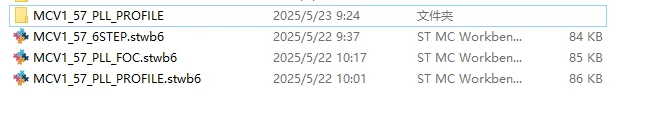

ZHOUXIANG
ZHOUXIANGAuthor
May 23, 2025 2:05 AM UTC
As the screenshot shows above, I creat 3 independent projects, MCV1_57_PLL_FOC(without profile), MCV1_57_PLL_PROFILE(with profile). I need to read the codes in these 3 projects at the same time, I will not want to regenerate again and again, it takes too much time. For verifying this issue, based on these 3 stwb6 files, I generate, compile, delete the output folder and repeat again. MCV1_57_PLL_FOC is always ok, but MCV1_57_PLL_PROFILE is always failed.
I have upload the stwb6 and json files, and list version and info below:
Environment Version:
MC Workbench 6.3.2
CubeMX 6.14.1
CubeIDE 1.18.1
PROJECT INFO:
MCV1_57_PLL_PROFILE.stwb6 = MCV1.json + TB 57BL75S10-225TF9HQ.json(unprofiled)
MCV1_57_PLL_FOC.stwb6         = MCV1.json + 57LSPRO2.json(have been profiled)
