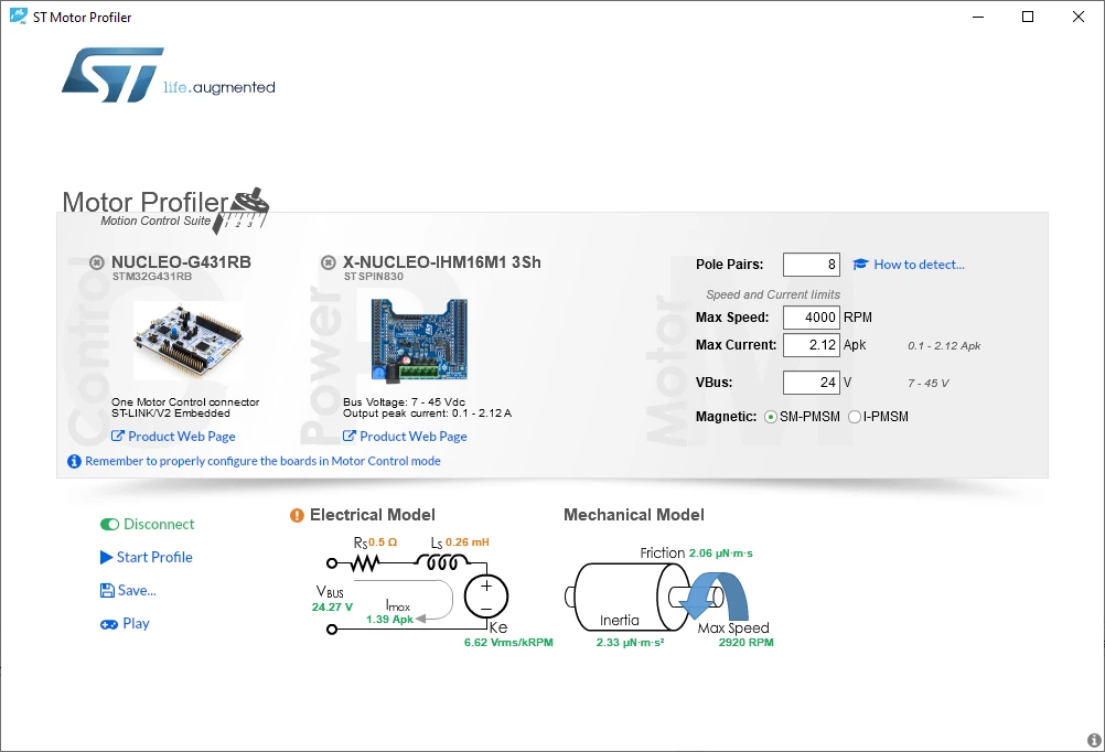

•   Using an X-NUCLEO-IHM16M1 on the NUCLEO-G431RB I was able to successfully run the MotorProfiler (5.Y.1). I’ve attached the profile results. With the ‘play’ interface I was able to control the speed of the motor within +/- 2920 rpm.
