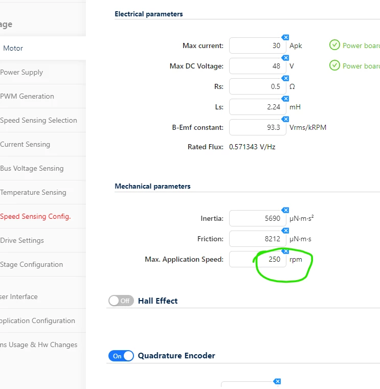

I’ve decided to try lowering this parameter from 2275 rpm (maximum motor speed) to 250 rpm (maximum speed for my application):

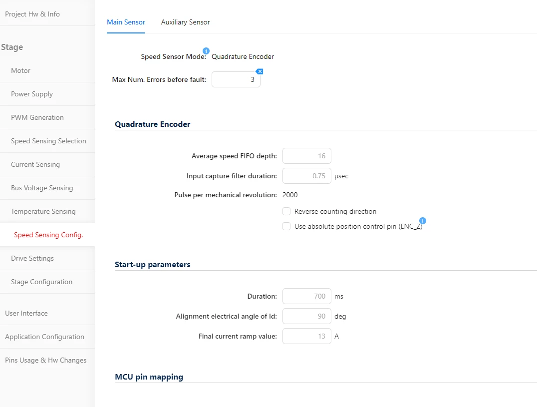

As you can see, when I change the value, an error in Speed Sensing Config appears:
The auxiliary sensor section is not active!
I don’t understand where the error lies.
Any value lower than 1600 rpm gives me an error; I don’t understand why

Hello ​@luke514,
Firstly, we apologize for the delay in replying to your post.
Thank you for your report.
This point has been reported (Ref CDM0066724) to the dedicated team to correct this point for next deliveries.
If you agree with the answer, please accept it by clicking on 'Best answer'.Best regards.GMA
