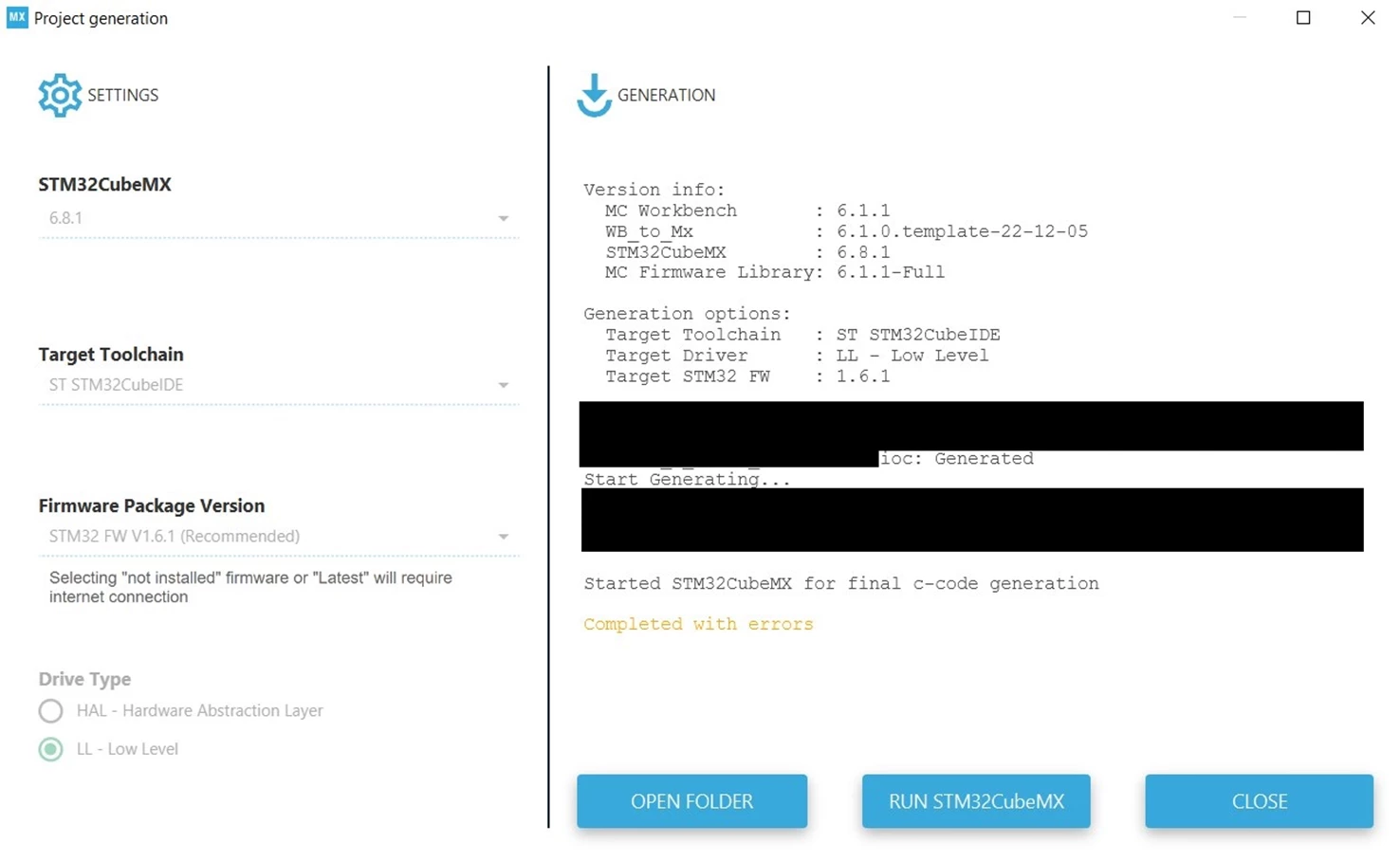

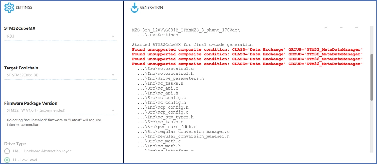

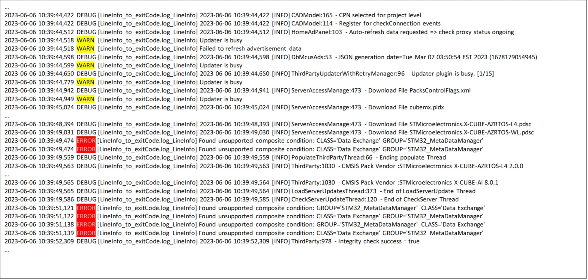

DOuel.1
DOuel.1Author
June 6, 2023
Thanks Zieb b.
  • Agreed, the generated code is the same as before.
  • Before doing as you suggested, I retried, as is, to see if there had been a new update or something that would have fixed the issue… you like the one that caused this to suddently appear...well maybe there was an update, but now I have 4 errors showing instead of 2. Actually if we look at the more detailed log, there are a total of 6, but the 2 "GROUP" ones are just not displayed .
(see the first 2 images below).
  • I then did as you suggested (folder already existed, but not the file, so I created it), but no change, same errors… but I had the Workbench already opened before creating that file.
  • So I closed the Workbench, re-opened it and tried again.
  • This time the error didn't get displayed…but neither did any lines after the line " Started STM32CubeMX for final c-code generation", which was followed only by and finished with only: "Completed with errors" …
(See last image below. )
And in the more detailed log file, no warning and no errors are shown… !?!
....though the final message in the GUI says completed with errors
  • It seemed to generate faster but I prefer to see what the errors are… I'll remove the file I created...
Thanks anyway Zied !
