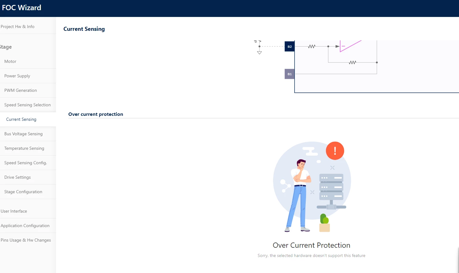

Hi everyone,
I'm working with the B-G431B-ESC1 board and need help setting up overcurrent protection. I want to ensure safe operation and prevent damage to the hardware.
Could anyone guide me on the best way to configure the current sensing and protection in MC Workbench?
Any insights, step-by-step instructions, or shared experiences would be greatly appreciated!
Thanks in advance! :rocket:

Hello LSerhii,
For some reason your B-G431-ESC1 description does not feature the OCP. Please make sure that you are up to date with our latest MCSDK version (6.3.2) and then recreate a project from scratch while making sure you are using the board description provided inside the package.
There should be no reason for your project not to feature the OCP.

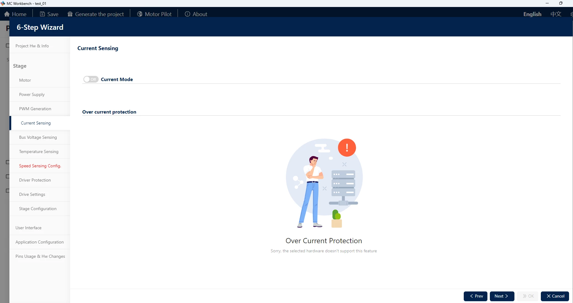

Hello Gaël A.
I think there is an issue with this version (6.3.2). I am consistently getting the OCP error.
Could you confirm it ?
