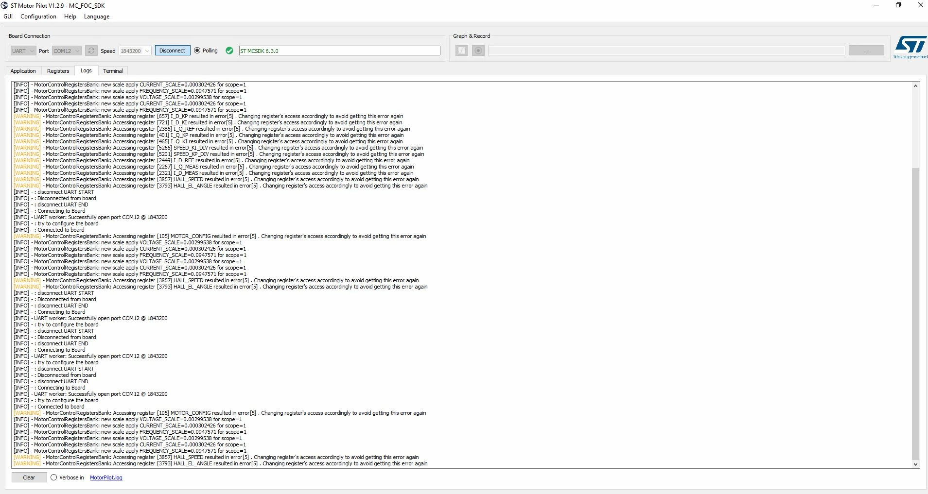

Today I checked a lower PWM frequency (16 kHz -> 4 kHz). Almost same motor performance result. See attached movie.
Please note the screencopy of Pilot log data; is this normal?

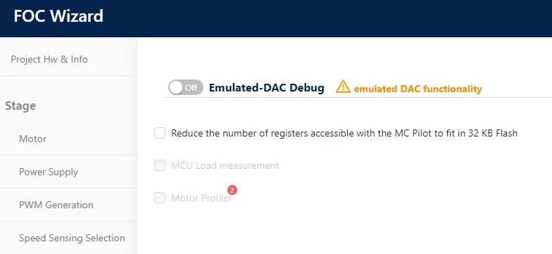

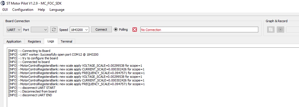

Some update.
The warnings can be solved by not setting the following option in MC Workbench
But the performance of the motor is still the same (first CW, then CCW, then communication error at USB)
See above log.

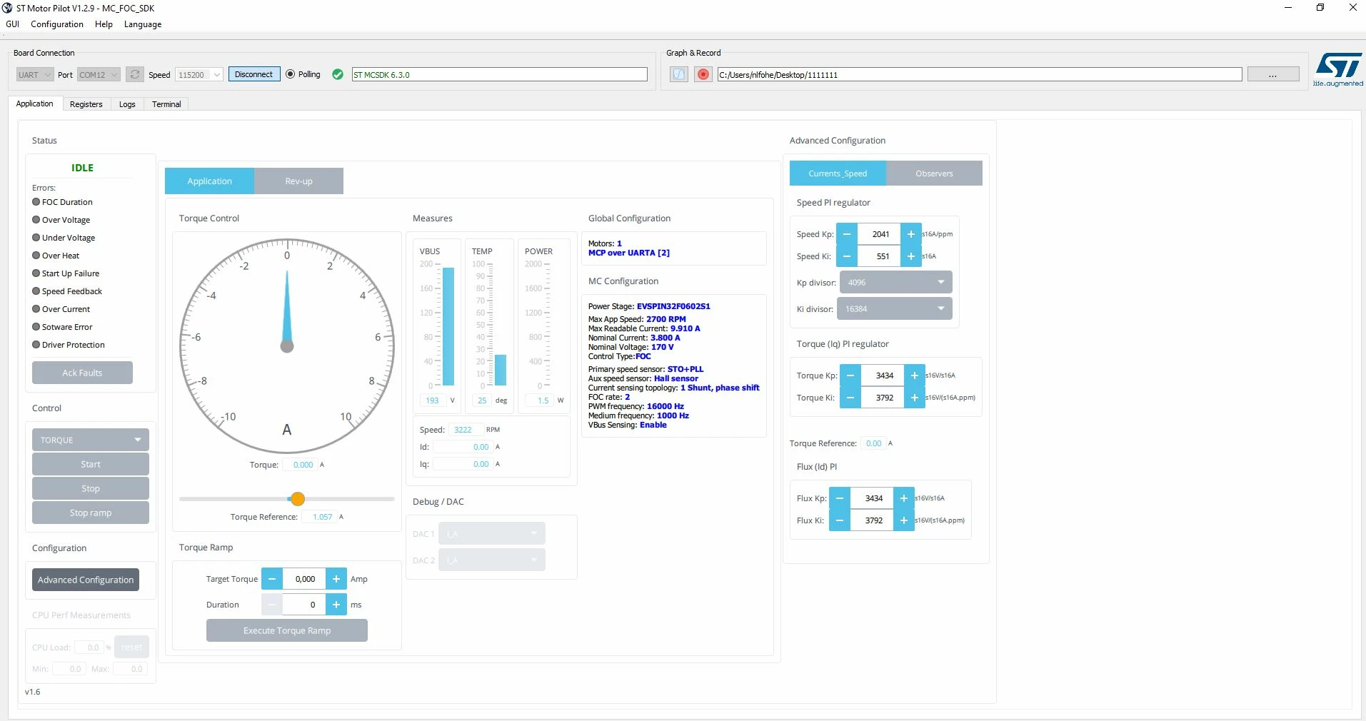

October 11, 2024
Hello GMA,
I tried to make a plot but it was not possible due an error (speed feedback) a few seconds after each start. See attachments.
GMA
October 14, 2024
Hello @FVan .1,
For error management, could you please have a look at user Manual documentation available through "Workbench tool">About>Documentations>Documentation>"User manual" tab, "Firmware errors" link, "7. Speed Feedback error" chapter.
If you agree with the answer, please accept it by clicking on 'Best answer'.Best regards.GMA
