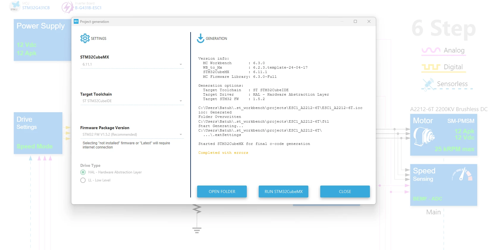

Hello there,
I am new to the MC Workbench and must configure the B-G431B-ESC1 to use it with a A2212/6T 2200KV Brushless DC Motor.
I created a new project in the MC Workbench 6.3.0 and tried generating the project.
Once the generation is completed I recieve the following error message: "Completed with errors."
I watched the tutorial on youtube which shows different behavior. In the youtube video several ".c" files are being generated and the generation is completed successfully.
What is my problem here?
FYI: I created a custom motor profile, which is very similar to the "Bull Running BR2804-1700kv".
Do you have any tips how to approach this, maybe use the Motor Pilot?
Thanks in advance for any help.

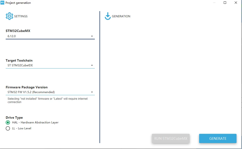

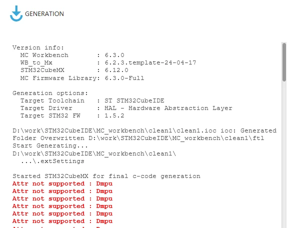

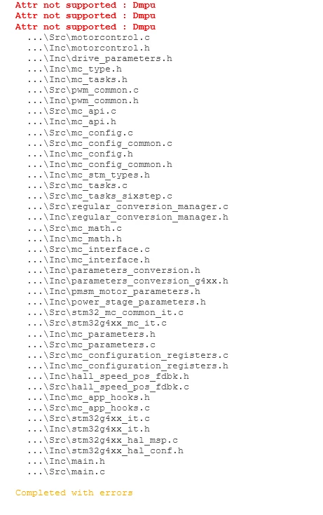

Senior
July 11, 2024
Hello Cedric,
I had errors when generate with MC workbench 6.3.0. below is the log. please have a check.
please help.
thanks.
STMBatuAuthor
May 18, 2024
Hello @cedric H
Thank you very much for the fast response.
I replaced the file you mentioned with the file you uploaded here.
After restarting MC Workbench the generation worked as intended, however additionally I needed to run MC Workbench as administrator.
The generation is now completed successfully.
Best regards :smiling_face_with_smiling_eyes:
