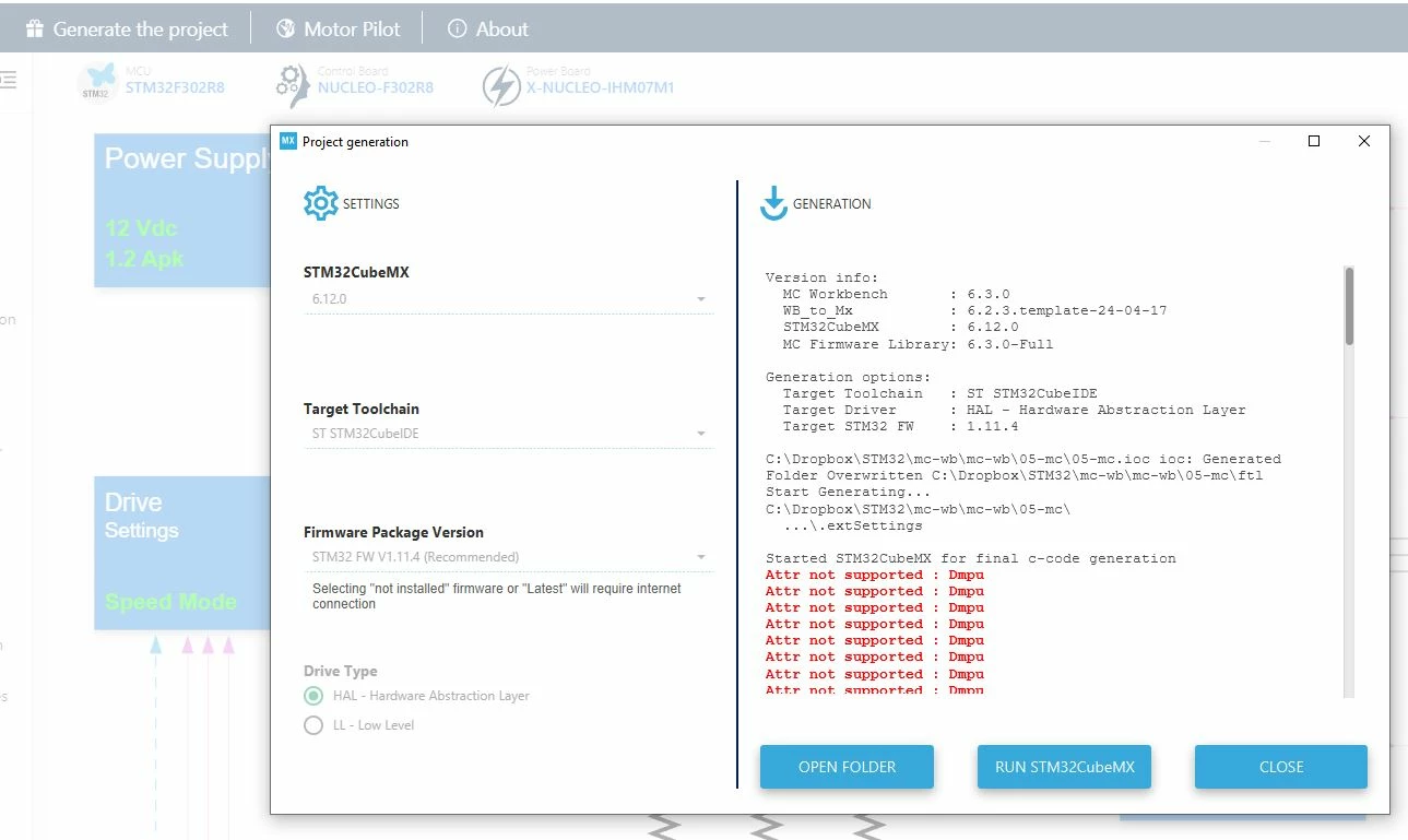

I am trying to generate code for "STM32 Nucleo packs FOC and 6-step motor control platform for three-phase, low-voltage and low-current motor" and I keep getting errors :-
Attr not supported : Dmpu  as in attached image.
I am using cubeMX12, I have updated Java recently and I have uninstalled and reinstalled CubeMX as well. Still no luck. Log file attached.

Hello @Sujoy_B
this error has been understood and will be corrected in the next version of CubeMx.
Nevertheless, a workaround can be proposed to you in order to avoid having this issue,
Please try after you have deleted the following files :
1- %HOME%\.stm32cubemx\thirdparties\pdsc\EmbeddedOffice.I-CUBE-FS-RTOS.pdsc
2- %HOME%\.stm32cubemx\thirdparties\pdsc\EmbeddedOffice.I-CUBE-FS-RTOS.1.0.1.pdsc
Please tell us if this solves your problem

Hello @Sujoy_B
regarding the log you have attached to your message, the project have been successfully generated, please try to compile it.
The error message is not a blocking one, we are investigating on that nevertheless  you can continue working on your trials.

Hello @Sujoy_B

HI Amina,
I took your suggestion made on 7/12 to ignore the error from MC WorkBench Generation. I compiled the code under CubeIDE and ran the code with target HW. It works.
I also compared two projects, one from the MC WB example, another one from what I created under MC WB, there is no difference technically.
But I haven't tried the suggestion you had on 7/15 to remove two files under CubeMX.

No workaround is needed, just ignore the error messages from Project Generation.
