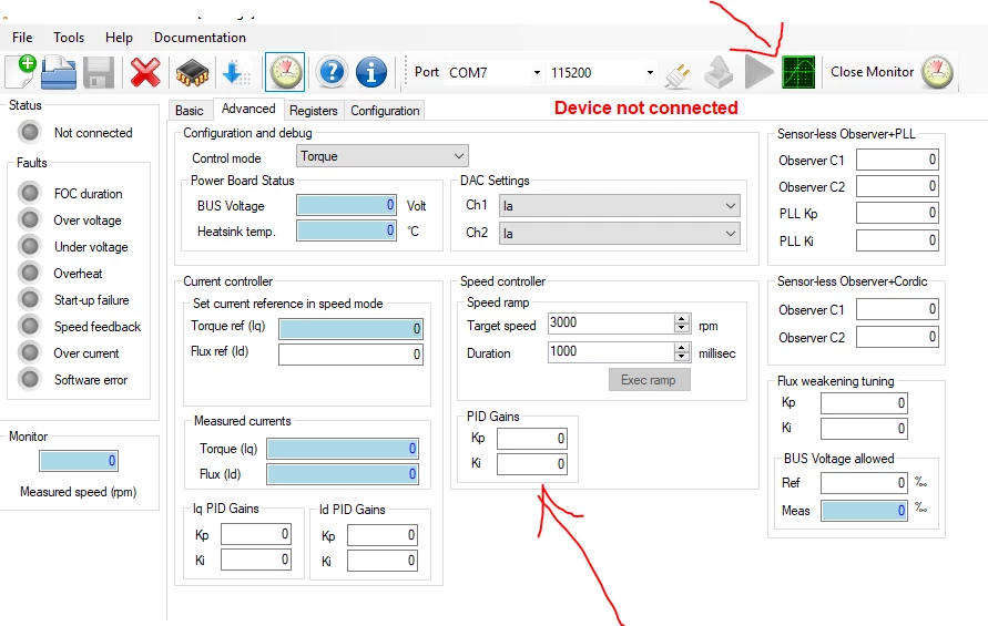

Dear nmamore,
it seems that your speed regulation loop is under-damped. You should try to:
  • decrease your Ki
  • increase your Kp
you can modify these values on the fly without reprogramming by using the motor control monitor in advanced mode. You can also use the plotting functionality to visualize the speed response. 0693W000005AGtvQAG.pngBest Regards,

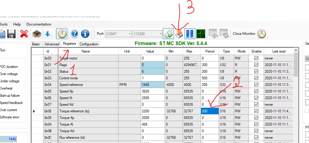

nmamore
nmamoreAuthor
Nov 5, 2020 4:13 PM UTC
Still struggling a bit. One thing I am noticing is that my Iq reference never changes. Based on how FOC works, shouldn't the Iq reference be changing as the speed changes since it is set by the speed controller PID loop?
Mathieu Casties
Mathieu CastiesBest answer
Visitor II
Nov 10, 2020 3:10 AM UTC
If you control your motor in speed mode, your iq reference actually changes you just don't see it. The advanced panel is not configured by default to update this value that's why the displayed value doesn't change. If you want to monitor it in this panel you must :
  1. go to the panel Registers
  2. set the "torque reference" update period to 200
  3. click on the update icon to validate
0693W000005ArrDQAS.pngAnyway, I'm not sure that this value is relevant for you to configure your PI in speed mode.
Decreasing your your Ki should remove the oscillation at some point .
Is it possible that the oscillation come from the motor load ? what is your application?
Maybe you could also share the speed response using the plotting functionality to give more information.

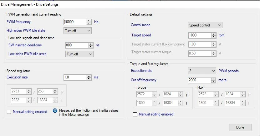

nmamore
nmamoreAuthor
Nov 10, 2020 2:08 PM UTC
0693W000005AwTBQA0.jpgMathieu,
Thank you. I realized shortly after I posted that it was the value from torque control which is why it wasn't updating in the workbench. To update you on what I've noticed, my performance is better after adjusting the PWM and FOC Execution rate. I think it definitely needs some more adjusting, but I am confused as to what I should actually be setting values to. I attached my drive settings as a picture. PID Parameters still need work, but I want to ensure my drive settings are proper before diving in too deeply.
On a slightly unrelated note, are you aware of an easy way to get info from the register menu? I know it updates the register based on the period, but I was wondering if there is a way to dump that info to some sort of log file?
Thank you for all the help thus far.
Mathieu Casties
Visitor II
Nov 11, 2020 5:27 AM UTC
Your settings seems correct, you can increase the execution rate, but if you see the error "FOC duration" occur, it means you increased too far.
