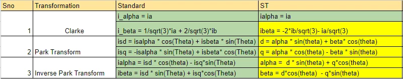

Thank you for feedback i have few doubts if you can clarify it will help me a lot.
The clarke, park and inverse park transform have different formulae compared to standard i have attached the image
_legacyfs_online_stmicro_images_0693W00000biDq1QAE.pngCould you please help me to explain why there is difference?
