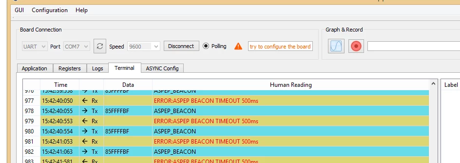

BIG BIG BIG problem to make this card (STEVAL-SPIN3204) work!! 3 days I'm trying to use it !!!
The challenge is to find the good programs. ST documentation is SO bad!
Ok I've installed X-CUBE-MC SDK - Y
(the note UM2310 is note usefull - lost time to seach this firmware which does not exist anymore!!)
Anyway... I try to use the example 6S_STEVAL_SL_VM
In ST Motor Control Workbench, at the top of the page it is written "Control Board STEVAL_SPIN3201"... I hope it's a mistake besause it is the example for my board SPIN3204...
I compile...
I open the project in STM32cubeIDE (What a headache for a rooky to make the difference beetween STM32cubeMX and STM32cubeIDE - How many soft to use a ST microcontroller??) When you used to use an Arduino or a PIC, it's so diferent, it is not understandable!!
A general presentation of how we must do to use your products is missing.

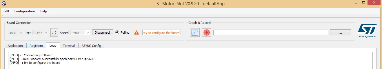

Anyway... I compile the project in STM32cudeIDE and I click on "run" to program the microcontroler on the board (SPIN3204)
I return to ST MC workench (ver 5.Y.4), and I click on "motor Pilot"
When I click on "connect" I obtain this answer:
0693W00000UFXFYQA5.pngIt is written "try to configure the board", and in the application, all is grey, I can't use it.
In the terminal windows, I have this:
0693W00000UFXK4QAP.pngWhat must I do??
Can you help me please?
