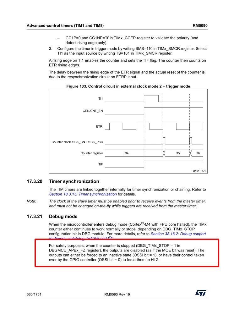

waclawek.jan
February 21, 2023
Thanks, @Fred V.​ .
> It is not present on F0 and F4
Indeed, RM0091 for 'F0 does not mention it, but:
0693W00000aHKszQAG.pngI guess you've checked some other 'F4 then the "classics" covered by RM0090, in which case determining whether this feature is or is not present may be more tricky than I thought...
Fred V.
February 22, 2023
Yes, you're right. I overlooked RM0090 and only looked at RM0390 which describes STM32F446xx devices. Sorry. Indeed, I do not see any easy rule to determine whether the feature is present on a given MCU.
