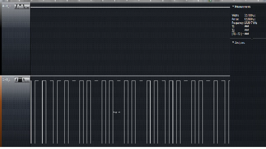

julienboudens9
November 14, 2012
Posted on November 14, 2012 at 09:41
Thank you for your reply,
I have changed the following params in drive parameters.h :
/* PWM generation and current reading */
#define PWM_FREQUENCY                    16000
#define MAX_MODULATION_100_PER_CENT
#define LOW_SIDE_SIGNALS_ENABLING        ENABLE
#define SW_DEADTIME_NS                   800 /*!< Dead-time to be inserted
                                                           by FW, only if low side
                                                           signals are enabled */
#define HIGH_SIDE_IDLE_STATE              TURN_OFF /*!< TURN_OFF, TURN_ON */
#define LOW_SIDE_IDLE_STATE               TURN_OFF /*!< TURN_OFF, TURN_ON */
#define CURR_SAMPLING_TIME               1  /*!< Sampling time duration
                                                           in ADC clock cycles (1 for
                                                           1.5, 7 for 7.5, ...) */
but I have always the same signals when I'm looking on JP1 et JP6 (on steval ifn003v1)
You'll find a print screen with the two signals
Gigi
November 14, 2012
Posted on November 14, 2012 at 11:00
Ciao
I have the suspect that you are using the STM32 FOC lib. 3.0 with the
STEVAL-IFN003V1 firmware patch.
In that case the
is skipped by the patch. So I suggest you to go back to the original version of v3.0 (before patch) or pass to the new v3.2.
Ciao
Gigi
