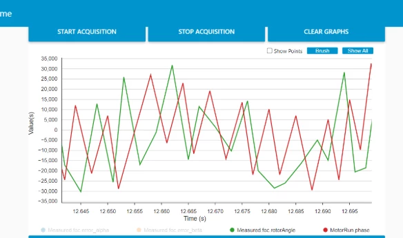

Hello everyone,
I am working on shifting sensored FOC to sensorless FOC for a BLDC motor using STM32F103C8T6. I have successfully implemented all necessary transformations (Clark, Park, and Inverse Park), and the waveforms appear correct.
To estimate the rotor angle, I am using a Sliding Mode Observer (SMO). However, since the STM32F103 lacks an FPU, So function like atan2f() increase execution time. Instead, I implemented an alternate method for angle calculation. I am using position detected by hall sensor as reference, but output of my sensorless algorithm is having some differences from hall sensor signal.
This is output waveform
Here is the code I am using for angle calculation:

FouadB
March 28, 2025
May I suggest using the atan computation method provided in our MCSDK. Based on the CORDIC algorithm, it should enhance your angle estimation accuracy.
This method uses the back-EMF (alpha, beta) in stationary coordinates as input for angle computation.
Additionally, we offer a complete FOC sensorless solution (X-CUBE-MCSDK) based on the Luenberger State Observer, which is compatible with the STM32F103.
Best regards,
Fouad
If you agree with my answer, please accept it by clicking on 'Accept as solution'.""
March 29, 2025
Thank you so much for your reply sir , i have written my own control for this , tell me according to my code what can cause issue.
April 10, 2025
Hello happy to tell you that issue is solved when we increase bemf (Phase ADC values are increase)
