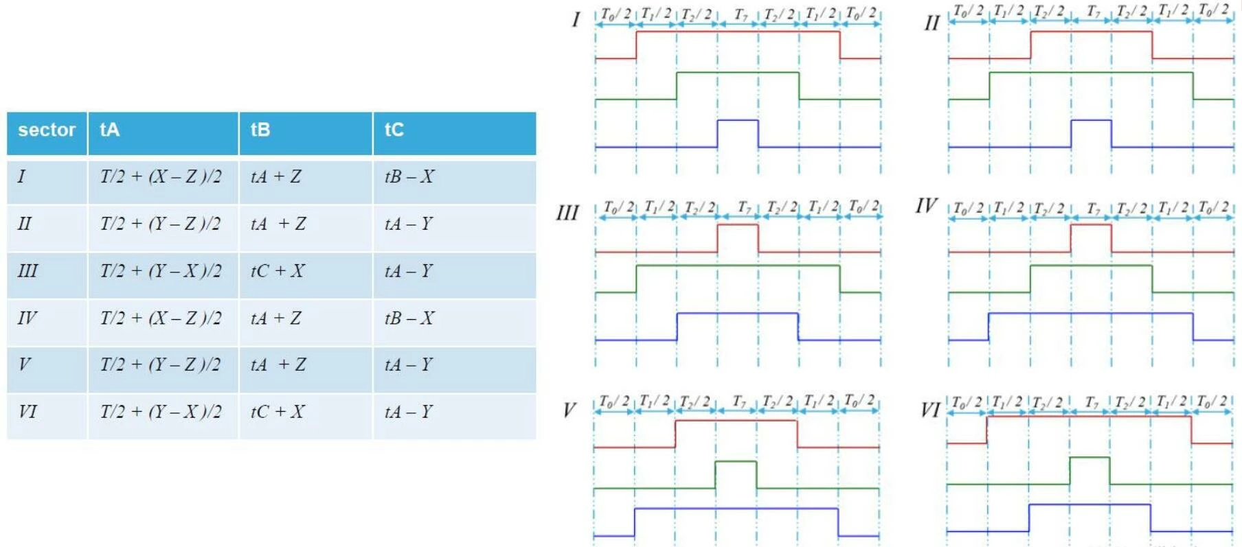

issue on ADC sampling point
in fuction:
uint16_t R3_2_SetADCSampPointSectX( PWMC_Handle_t * pHdl )
/* sector number needed by GetPhaseCurrent, phase A and B are sampled which corresponds
 * to sector 4 */
 pHandle->_Super.Sector = SECTOR_4;
Phase A and B is corresponding to sector 4 or 5.
in sector 4 or 5 as the picture below,to avoid sample the phase C whose duty cycle is close to 100%,I think it should sample phase B and C instead of phase A and B.why.
1 reply
THA.1
November 25, 2021
