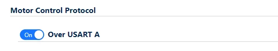

I am trying to run the B-G431B-ESC1 board for the first time (also it is the first time I am using STm software tools) and ran into this issue. I tried compiling for other boards and even other exemples and none of them generated the mcp.h file in the includes folder. Am I missing something? Did anyone ever had this issue before?
Apparently the file in the project or include paths. Find the file in the MCSDK

Please ensure the following is enabled in workbench
The mcp.h file is located in the following folder
\MCSDK_v6.2.0-Full\MotorControl\MCSDK\MCLib\Any\Inc

Thank you both, helped a lot!
