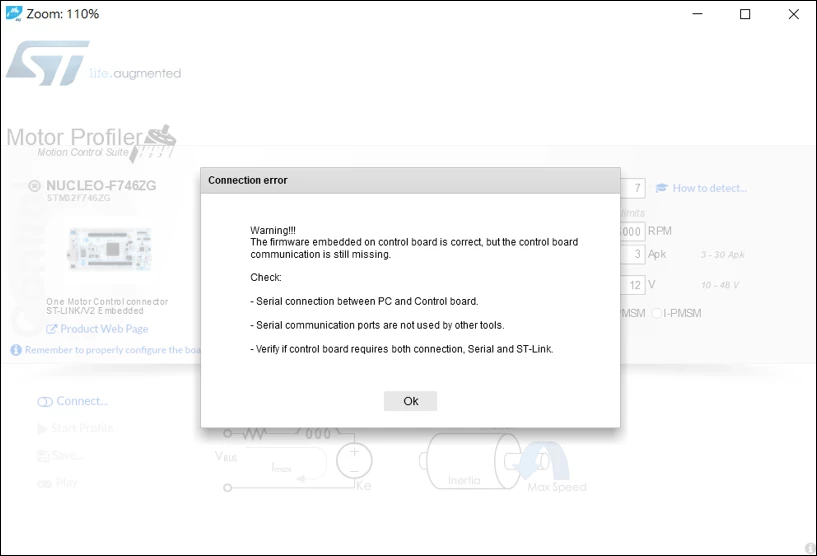

1.    F746ZG can’t connect motor profiler.
if I only use a USB, there will shows an error.

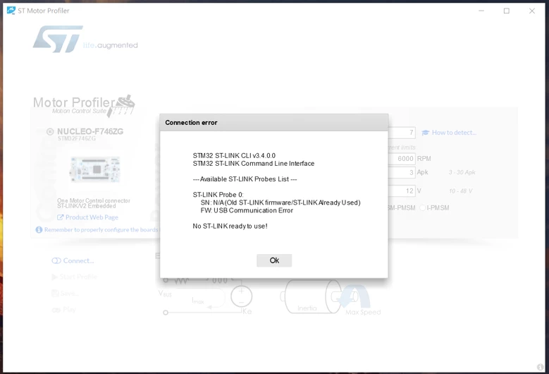

 0693W00000NrsTUQAZ.pngif I use USB and ST-Link both, there also shows an error.
 0693W00000NrsTZQAZ.png       Other people also have same problem, and the problem isn’t solved.
       https://community.st.com/s/question/0D53W00000WbUKXSA3/st-motor-profiler-with-nucleof746zg-ihm07m1-connection-error
