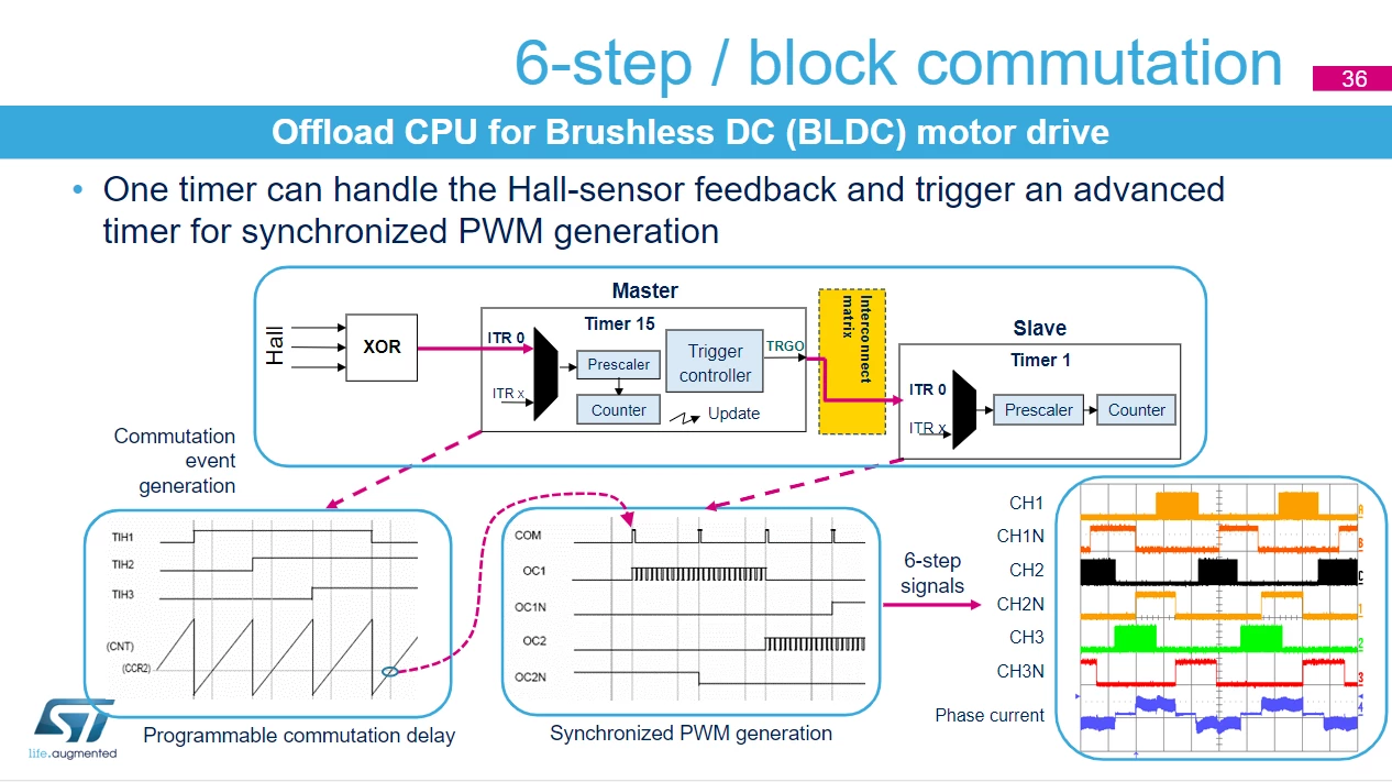

Hi.
I don't find a sample code.
But AN4776:General-purpose timer cookbook for STM32 microcontrollers document will help you.
Read the page 64, Synoptic schema of two complementary N pulses waveform generation
example.

I want to do the same thing.
Do you find a solution? Do you have a sample code?
